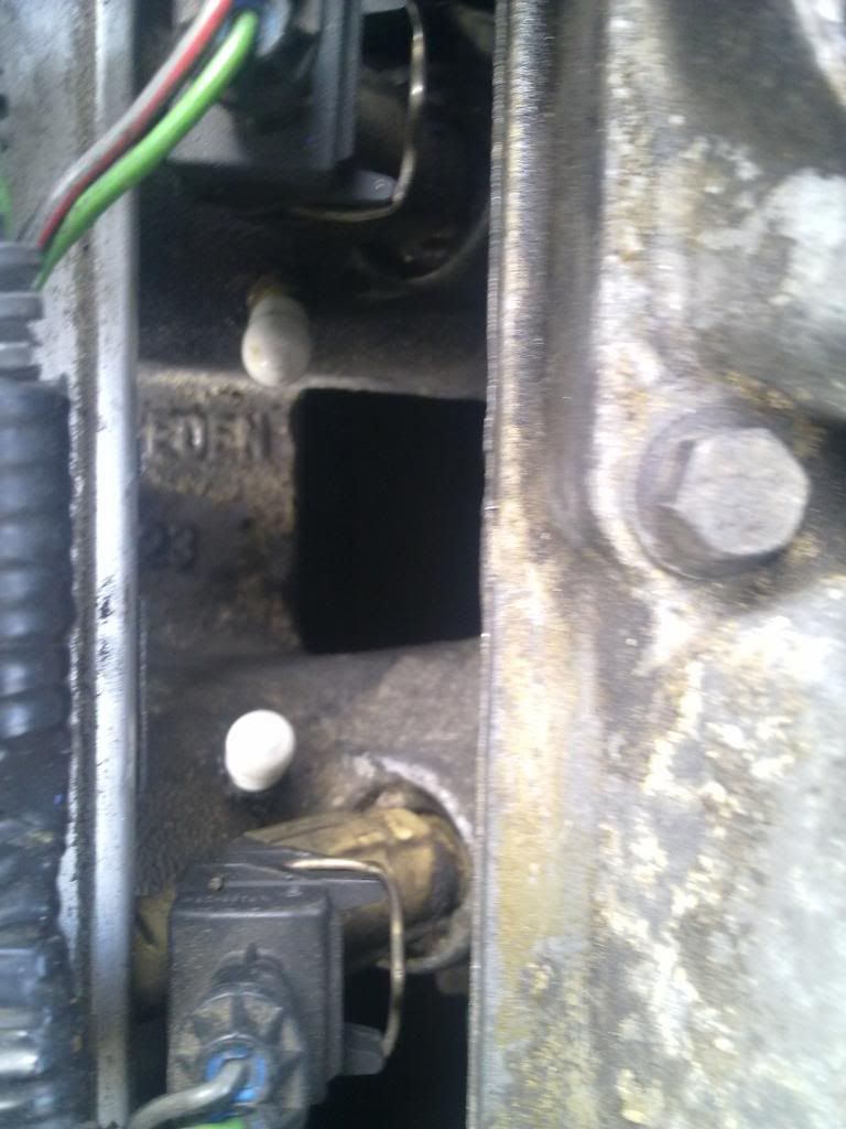

#207 Post by Mitsuru »
Worked on mother's Volvo.
The previous owner had removed the lpg system to put on another car.
But to block off the holes in the intake manifold that had been connected
to the lpg injectors, the guy had cut the pipes and just filled the ends of
the pipes with some kind of sealant. Which wasn't very good and had
caused a vaccum leak and rough ideal.
I had to buy vaccum caps off ebay as none of the auto shops I went into
had them and one guy who said he had been the business over 30 years
had never even heard of them!! (Which I find hard to believe!!)
A bi of gasket sealant in the end of the caps to help give a good seal. And
I used the surgical claps to hold the end of the caps to push them on the
lpg fittings rather than the pliers.
No problems since doing it
(fingers crossed and touch wood that was the problem ;) )
