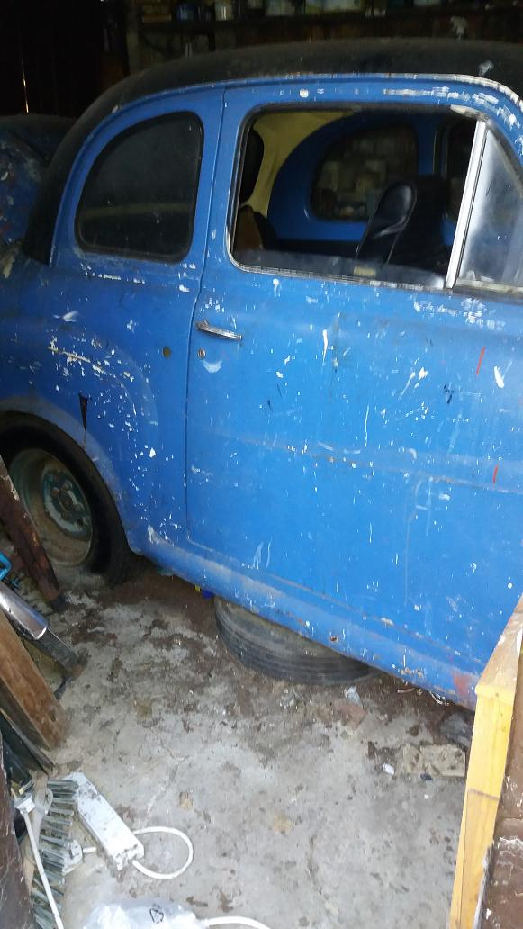

Well it's not the fuel injected one but it is mine! Spend several hours yesterday getting access to my A35 in my late Mother's garage.
As I expected the bonnet has been bent in, but I know of a few around or a man that might be able to "unbend" it.
It took a while just to get to this stage as just inside the door where step ladders (that looked lethal if you tried to use them!) and TWO broken lawn mowers plus bags of rubbish .. I would add I started to remove parts several years ago .. the hole in the rear panel is for an alarm key .. the hole in the sill needs attention! No the rear wheels are no standard .. 5 1/2" banded steels with 185R13 tyres. They came with 4 1/2" rims and 5.20 cross plies. Mine did at least go around corners!
Once I cleared the side I was able to squeeze past an old broken gas cooker (why? :roll: ) and get one of the garage doors open ...
I never knew my parents knew Picasso .. :shock:
It's a Mk II (no BMC never made one!) and that boot handle is the more modern Mini Clubman one. Still locks and unlocks too!
So it's now got four wheels and tyres that hold air so it's at least moveable .. push me, pull you moveable .. next up is to find someone to transport it home for me ..
The JPS Formula 1 stickers in the rear window date it's last excursions into the outside world .. I'm sure the offside one said "F1 Belgian Champions"!
After removing several plastic storage boxes, books and sheets of 1/2" plywood I managed to get the bonnet open too ...

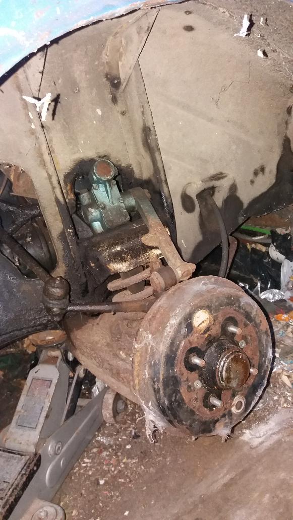

So here are those 8" drums ..
I was surprised at how easy the car was to move until I found the 8" shoes in a cupboard in the garage! And the brake return springs under the car ..

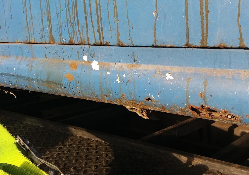

Tin Worm!
Tin Worm!
The nearside sill was a lot worse than I remembered .. the offside isn't quite as bad ... but I now have two brand new sills, and some wing repair sections sitting in the garage ready for that fateful day when I get the angle grinder out! (which won't be tomorrow!! Still have to strip the mechanicals out and get it on the spit!! :thumbs:

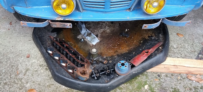

Firstly the rad came out ..
There wasn't much in the way of coolant which was good as this is over 40 years old now! I also drained of 40+ year old 20W50 from the engine and gearbox ..
Then rad fan and water pump came off .. both relatively easily.

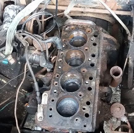

As the engine is seized I wanted to see what was in the bores ..
That is penetrating fluid in the bores .. engine is still seized .. it all came apart very easily apart from a coupld of studs and in teh process iof lossening one, I managed to take out the engine plate! :(
I loosened off a number of bolts and nuts for mountings, gearbox, etc while I was in the mood preparing the way to drop the egine and gearbox out next time.

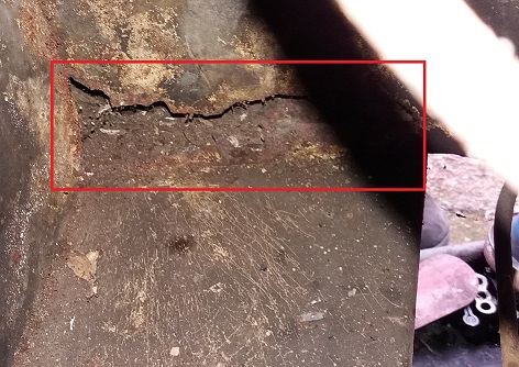

After clearing away the detritus and poking about between the two fron panels I found another candidate for the mig ..
... the driver's side is similar but will need work as this is a common area for rot. Several closed off areas that catch and hold muck .. usually damp muck!

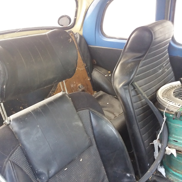

I also started to clean up the interior, but that can wait until next time!

So far it's not too bad and the main places that A35s go .. bottom corner of front inner wings, bottom of front panel (and inner), bottom corner of wings, outer sills and rear bottom edges of wings .. all the places that would have got the fibre-glass patch-up treatment in the 70s! ;)

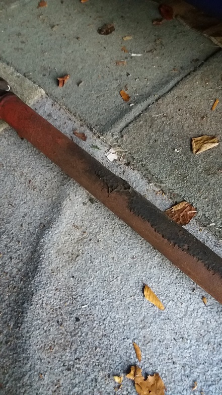

I've started to take the Austin apart ... most of the interior is out and I'm pulling the loom. I've now got the car up on stands so today took the opportunity to remove the propshaft and then drop the engine and gearbox ..
The propshaft shouldn't be rusty .. it was half coated in underseal! Well half won't rust! ;)
Given "most" of the underside is undersealed it is remarkably solid. There is a rust hole in the passenger footwell and two crack where the front tilting seats hit the floor if dropped. Most of the rear rust is confined to the outer sills, bottom of the front wings and the front panels.

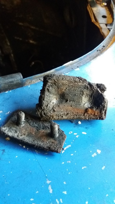

While wrestling with the gearbox and engine I heard a metallic clink as something hit the floor .. half an engine mount! :shock:
