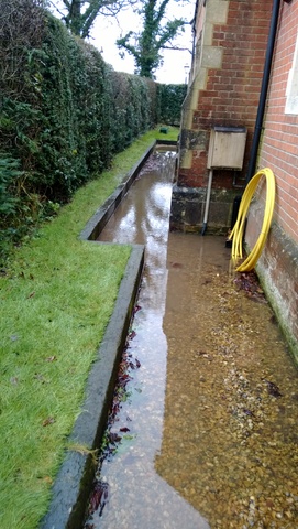

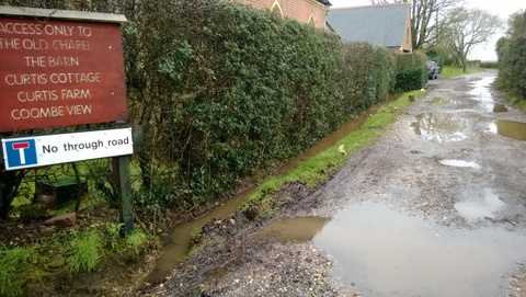

Not much done in the shape of car related projects over the holidays due to issues on the home front - yet more flooding - this time at least it was on the outside of the property and no effect on the interior - still needs to be sorted though !!! To the rear of the property / side of the garage is a large field which is approx 1 metre higher than the lane - the water drains from the field into the lane - then travel down the lane and fills the ditch to side of our boundary - the ditch has nowhere to drain to so it overflows into the side path of the property it then travels all around the property and in effect forms a moat
I have lifted the manhole chamber covers in order to drain the water away from the side of the brickwork (which is a 20"solid brick wall) otherwise we are likely to have allsorts of problems at a later date (bearing in mind that the property was built before damp proof courses were even thought about)
I am going to have to sort this problem by installing a couple of land drains to the base of the field and then convert the open ditch to the side of our property to a French drain and divert the water to the main drain. Add to this the fact that all the gutters were overflowing and have not been cleaned in at least the last 10 years - some of the surface water drains are running backwards and are discharging water to the side of the property rather than draining it away, some rather dodgy electrics, a cooker / boiler (Rayburn) that has managed to consume £450 of gas in a month

I don't want to teach granny to suck eggs, but I'm not sure that filling a gutter would be the best solution - even if it is a French drain - especially if there are trees or a hedge near it. Most of the wet spots on the farms I have worked on have been caused by farmers putting tiles in gutters and levelling the ground to make a nice flat field! Tree roots head for the water that's in the drains and ruin the dashed things
I have a similar problem at the moment: I put a nice plastic drain in six or seven years ago and nearly killed myself doing so: it was a warm month and the clay soil was dug by hand (hence the purchase of a digger!). I put two shanks to it this year, but haven't got round to sorting a connection to a main drain because I need to be able to get the tractors and Landy through where the join will be. In the wet weather, the water collects in the "soakaway" (some lumpy rubble), fills it up and now the whole lawn around the shed is flooded and the water runs along the end of the house (past where the new connection will be) and along the front to the drive's gulley!

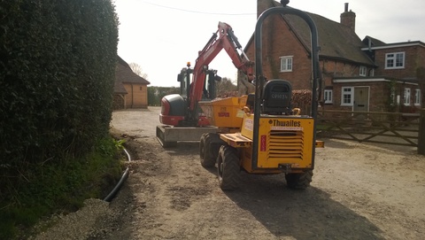

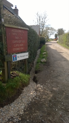

Fed up with water lapping around the property and the fact that my neighbour had just ordered a new Merc sports convertible and was keen to see the pot holes in the lane gone - I managed to get one of my sub contractors to come in and sort the drainage I organised the plant & materials and we cracked on installing land drains in the problem areas on the lane We also graded the potholes out on the lane which is circa 300 metres long prior to rolling it with a tandem roller - 80 tons of road planning's were brought in and we resurfaced the whole lane - I spent an entire Saturday rolling the planning's in to ensure that were firmly consolidated (and I ached for the rest of the following week) Fortunately I was able to keep the costs tight with trade contacts & suppliers and has the lane provides access to 5 properties the costs are split 5 ways - Now if only we could charge a toll for the walkers that have a public right of way down the lane
