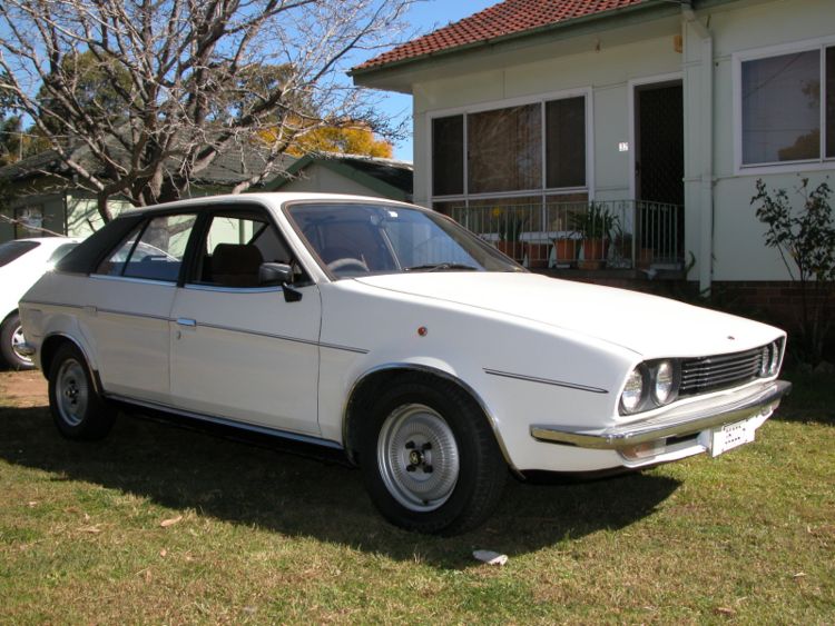

Refering to the number of Princess (Wedge) cars surviving you are probably unaware that a few exist in Australia. Probably 5.I have one, a 1979 2000LT HL which is still quite roadworthy with minimal traces of rust. I have just reconditioned the rear gas displacers using the method mentioned here on this topic. Worked well but now I realise the fronts need doing as well as it sits a bit low and has a firm ride. I used 170 Psi attempting to use nitrogen but releasing the fitting you lose some pressure. I ended up using compressed air. There is a better way to charge the gas units using nitrogen. There is a fitting that is fitted by threading the gas bowl and screwing this fitting in with sealing. This fitting is used to charge nitrogen filled shock absorbers and basically has a silicon diaphram that a hollow needle can push through. The silicon collapses and seals when the needle is removed. Here are some photos of my car. I will post photos of the rear suspension work later on.
							- Attachments
- DSCN0007RS2.jpg (82.82 KiB) Viewed 3365 times
- DSCN0006RS2.jpg (78.24 KiB) Viewed 3365 times
- DSCN0004RS2.jpg (75.56 KiB) Viewed 3365 times
- DSCN0002RS2.jpg (89.1 KiB) Viewed 3365 times
