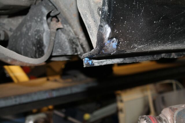

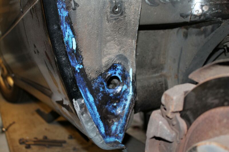

Decided I use this weekend to go over the corrosion issues on the mx 5 and wax it before the winter, there was some rust bubbles on the rear of one sill/lower rear wing, I cut the wing away and fortunately the sill underneath was fine.
The other side was much better with just a bit of stone pecking on the flange.
Also cleaned up in the wheelarch, I can see why these rust so badly, there was virtually no paint on the outer edge of the inner arch, fortunately on our car this had only resulted in light surface corrosion which was easily cleaned up and treated, also the seam in the arch was not properly sealed on the side with the corroded sill allowing water and dirt into the sill, so much for Japanese build quality!

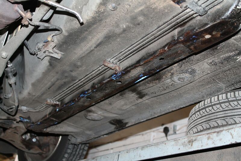

The only other issue is the rh chassis rail, it has suffered from the common mx5 problem of being grounded and damaged, it is not pretty but structurly ok so the plan is to clean it up paint and wax.
There were also a few minor spots behind the wheelrach liners they got the same treatment.
I will get the welding done tomorrow and start the painting /waxing.
All in all it could be a lot worse, and hopefully we can keep the corrosion at bay for many years with regular wax / oil mix treatments.

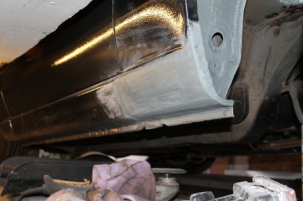

finished the mazda, welded new metal into the rear of the sill,
then primed and painted it.

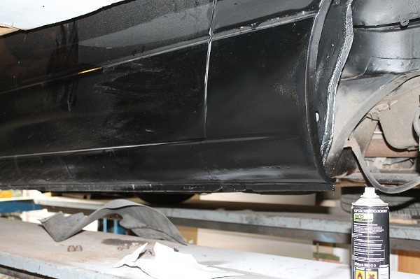

after which I move dont to waxing it all the cavaties were treated with waxoil dilurted with engine oil, and the the underbody with black waxoil, the only problem is the last 6 inches of the plastic tube got stuck in the sill and are still there!
At some point I want to do a more thorough job on the front and pull the bumper and wheelarch liners off but for now this will do.

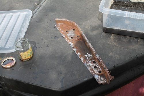

other things I have been doing, I have placed the door pillar off the minor in molasses to see if the rust removing properties work,
we will see what it looks like in a weeks time.

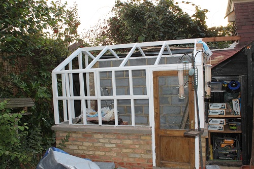

But what has really been taking up my time and limited the time I can spend on the cars is this.
before I got to this stage I had to remove some old buildings and lay a new patio, this is the last part of the job, next weekend the roof will go on and then the glazing, follwed up by a light and painting the wall, the door also needs modifying to fit properly but overall it is almost there.

Did the molasses treatment work?
Re: kevin s's blog
It removed the lighter rust but didn't do much for the heavier rust, next project is to build a blast chamber.
