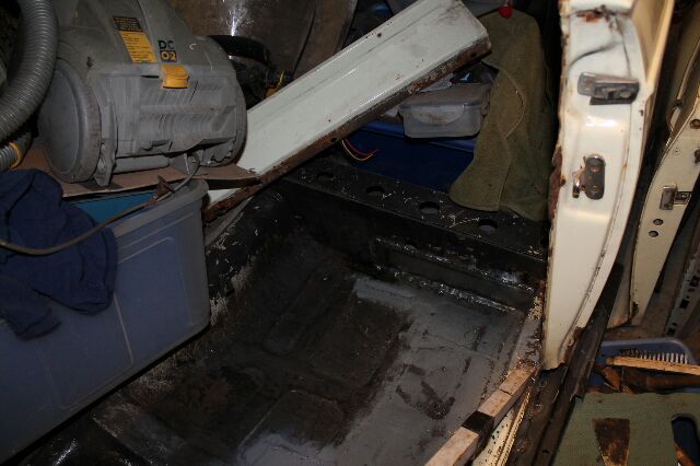

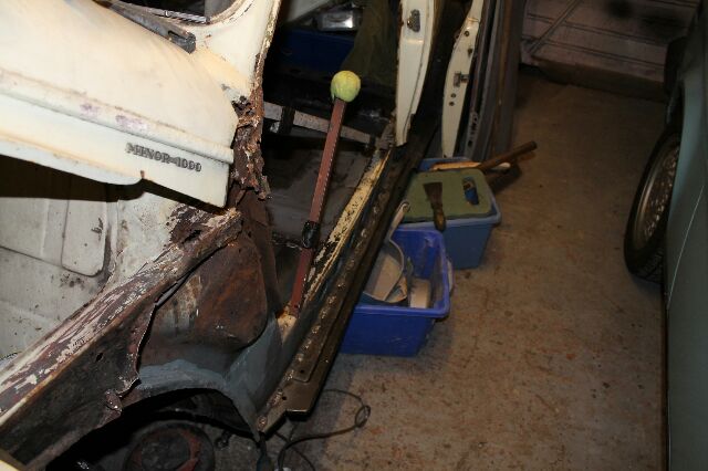

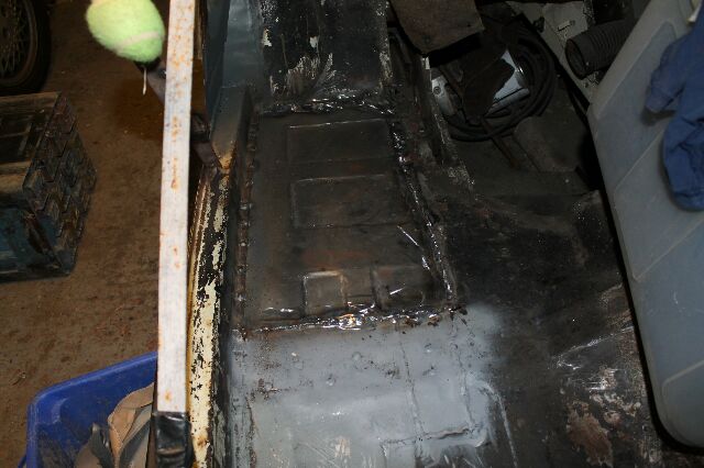

Spent a couple of hours on the minor today, welded the front floor section I made a couple of weeks ago in, the final piece of the rear seat kick plate and the outer sill, this completes the floor and sill repairs, next up is the a pillar which will allow me to hang the door and then finish the repair to the rear bodyside.

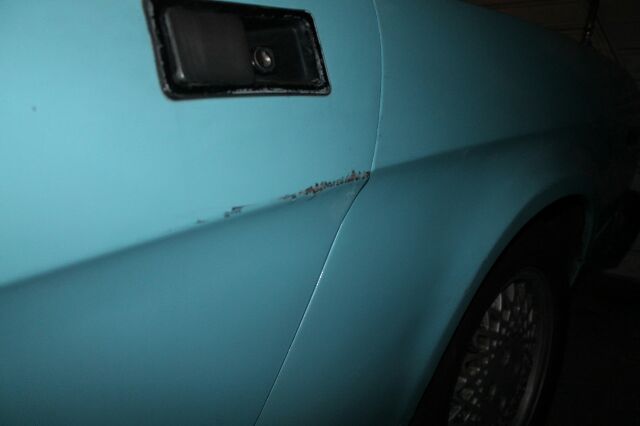

As always more tasks come up, walked up to the tr today and noticed this, someone has hit while parked somewhere. I will touch it in with a brush until I get the time to do it properly.

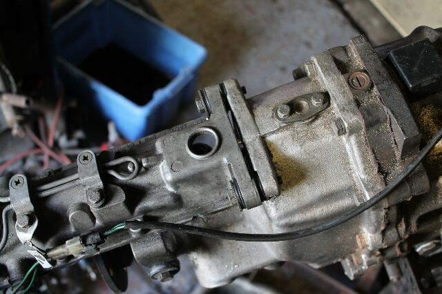

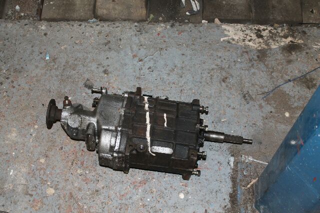

Started on the tr gearbox last night.
Firstly I stripped and replaced the oil in the "new" gearbox.
The old oil was actually pretty clean so a good sign.

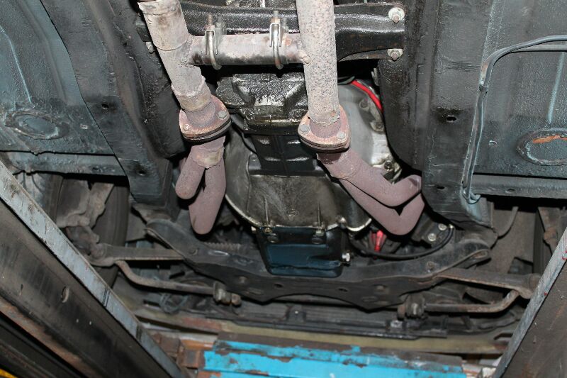

Next up was starting on the removal, this is the starting point.

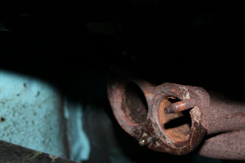

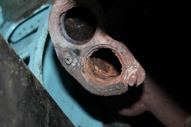

First step was removing the exhaust downpipes, all was going well until the last nut when the stud sheared.
Fortunately it is on the side with good access so If I can't get the remains out by welding a nut on it I will be able to drill it out in situ. Also both the down pipes are thin and holed around the lower flared joint so new sections will need welding in here.

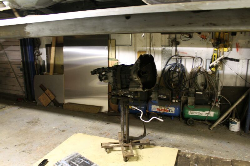

The prop, gearstick speedo cable and wiring harness were removed next, then all but 2 of the engine to box bolts (easily accessed from underneath with a long extension). the jacking beam was then used to support the rear of the engine under the sump and the gearbox x member removed.

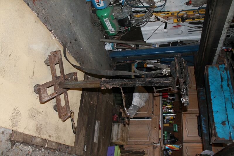

Next up was to get out a contraption I made when I had time on my hands around 18 years ago before kids came along. Basically it is a transmission jack made out of an old trolley, a consul classic jack and the angle iron from an old bedsted.
With this the trans came out ever so easily with no drama.

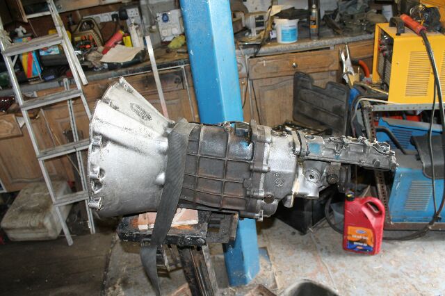

The result of the evenings labour are the clutch housings are now swapped, and the new box is on the stand ready to go in, the only problem I have is the forward gear shift housing top hat rubbers are shot (the rear ones are poly) but I should be able to make something with a slice of hose and some rubber washers.
This all that was left of the 4 rubbers.

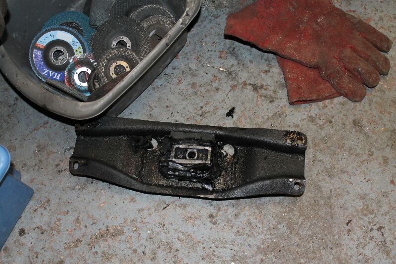

This is the gearbox mounting rubber, approx 18 years ago I modified it to take Ford rubber because the BL ones seemed to be made of cheese and were hopeless good news is the Ford ones are still cheaper so I will do the same again.
Plan is to get the box back in today do the exhaust repairs then finish it off in the week when the new mount turns up.

Got the gearbox back in, it slid straight in so it only took 15 minutes before it was all bolted up to the engine.
Fitted the clutch slave cylinder, wiring and speedo cable, then lifted it up into position before I started on getting the broken stud out.
Firstly the home made bushes for the remote, I used a piece of hose cut overlength so it swells as the bolt is done up along with a couple O rings.
Gearbox eady ti go in and cleaned up a bit.

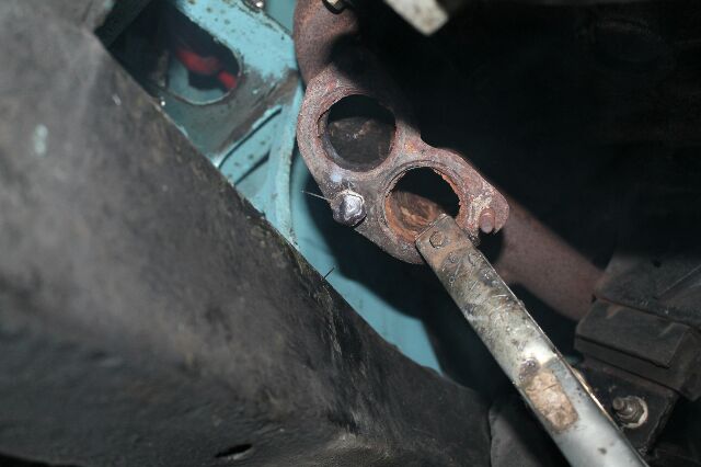

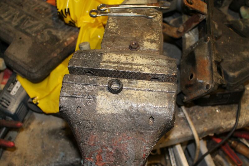

Firstly to get the stud out I tried welding a nut on.
Unfortunatelly all that happened is the stud snapped lower down, so I then had to drill it out, firstly the top was ground flat and centre punched.
kstrutt1
Posts: 516
Location: essex
Re: kevin s's blog
#187 Post by kstrutt1 »
Next up it was drilled through with a 1/8 drill
Then it was drilled out to the correct tapping size for M8 and tapped, result is

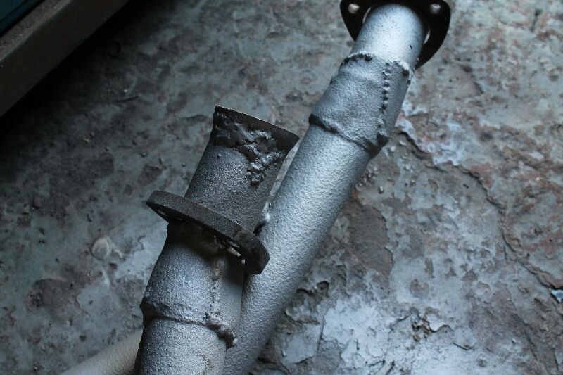

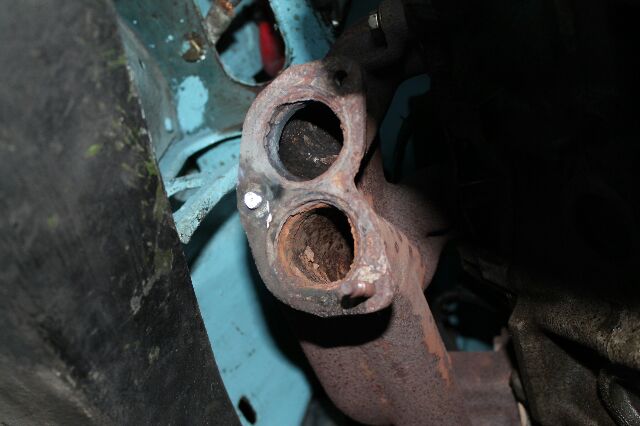

Next up is welding up the downpipes, they really have had it with several pin holes and cracks around the lower flange, the suggestion that I might need £160 worth of exhaust was met by comment about having too many cars from she who must be obeyed so welding up the old ones it is!

Most of the tr7 is metric, the exhaust manifolds are sd1 and the other 5 studs are m8, the rover v8 seems a mixture I suspect as parts were modified they moved to metric.

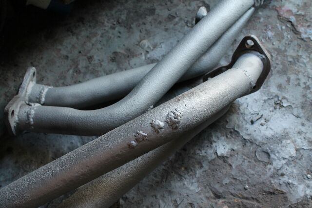

Today I welded up the manifolds, not pretty but should last another 2 or 3 years suprisingly the metal was pretty thick around the pin holes so these were easily welded, the flange was a little more difficult an I ended up laying a fairly large area of weld on, afterwards I gave it all a coat of vht which may help a little, I will though keep my eye out on ebay for better parts.
