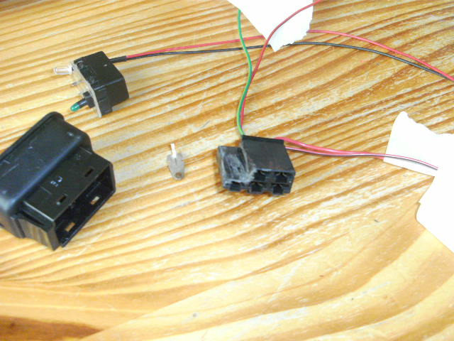

for the fog lights the switch , a cheap aftermarket one has failed so I bought a proper Mazda one but then I realized there would not be a tell tale as I have the Eunos cluster, I have come up with a solution though, the switch is backlit with a green LED, the plan is to put an additional bright orange LED inside so when the lights are on the fog light picture glows orange, when it is off the green backlight will still be visible. This though means I can't fix this until the LED I have ordered arrives though.

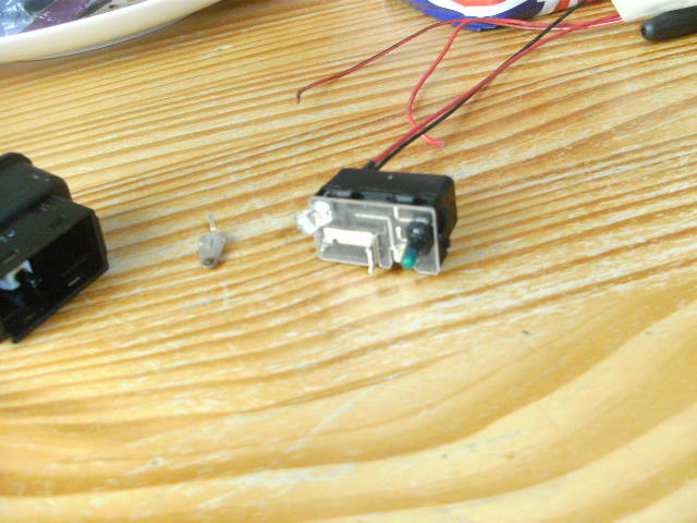

I also fitted the new foglight switch, I wanted a matching mazda one but because mine is a jap import there is no tell tale in the cluster, so I fitted one in the switch. The switch is backlight normally so pulled it appart drilled a hole through to the back and added an addional bright orange led inside the plug also had to be cut away to clear the wires, now when the lights are on the picture on the switch glows bright orange.

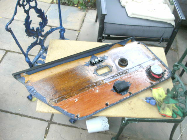

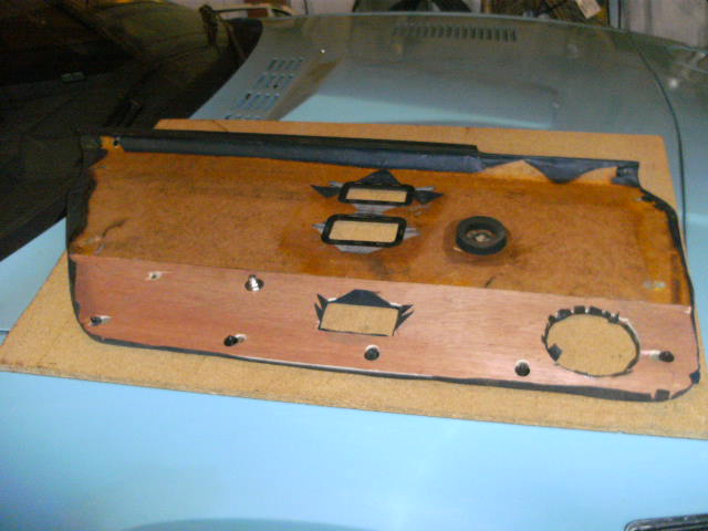

I have also been addressing the dodgy door trim on the tr, the backing board had distorted and torn at the bottom, new door trims are £160 so that was out, as the covering was fine I decided to repair it. Normally I would replace the whole board but in this case the top edge is moulded so not easily reproduced. I therefore decided to replace the bottom 6 inches or so disguising the joint under one of the moulded feature lines.l cut the damaged part out:
I then cut a new lower section out of 4mm ply.

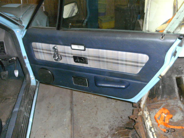

I then used grp tape to join them
The covering was then stapled back on and the trim refitted to the door, end result as good as new.

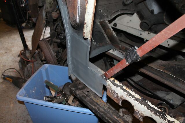

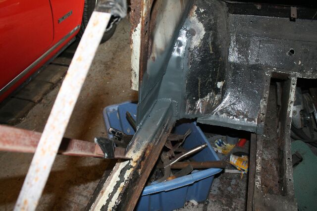

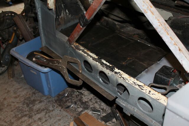

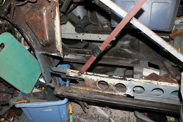

Done a little more on the minor today, braced the door apperture then cut all the rust out the base of the A pillar and cut the rusty front floor out.
Then welded new metal in, the corner is now nice and strong.
I have also decied to weld plates over the four large holes in the boxing panel at the base of each pillar, from a strength point of view they are in the worst possible place, I Suspect they were put there for weld access, but this is not needed when mig welding together.

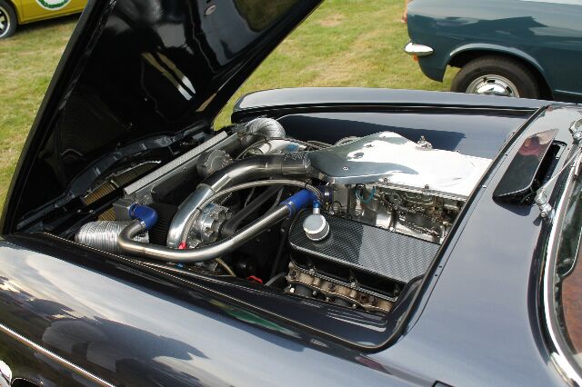

The mk10 jag was superb, a twin supercharged v8 producing around 800 bhp!
