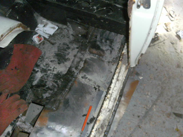

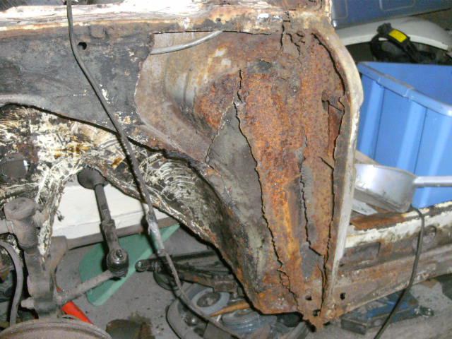

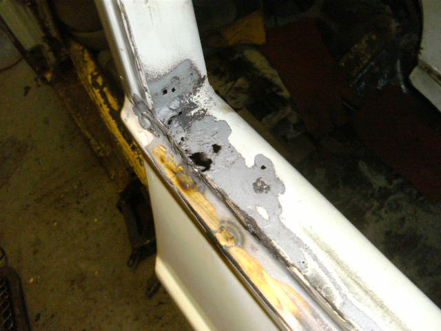

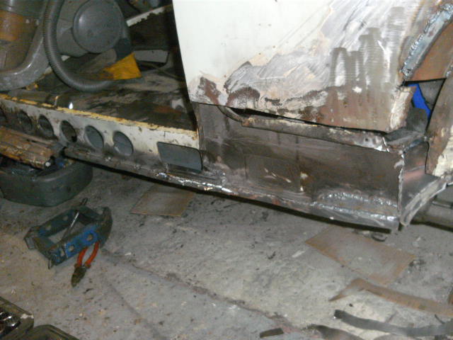

Mixed and layed a ton of concrete foundations first thing which meant I could not do anything else on the garden so spent the day on the minor.
Firstly we took the door off and then the wing, revealing a whole load more rust (pretty much what I expected). I then made and welded in a new section of floor /sill bottom and a few small patches to the boxing plate, I didn't quite finish as I ran out of gas.
I also finaly got to try out the sandblasting pressure pot, which seems to work pretty well.

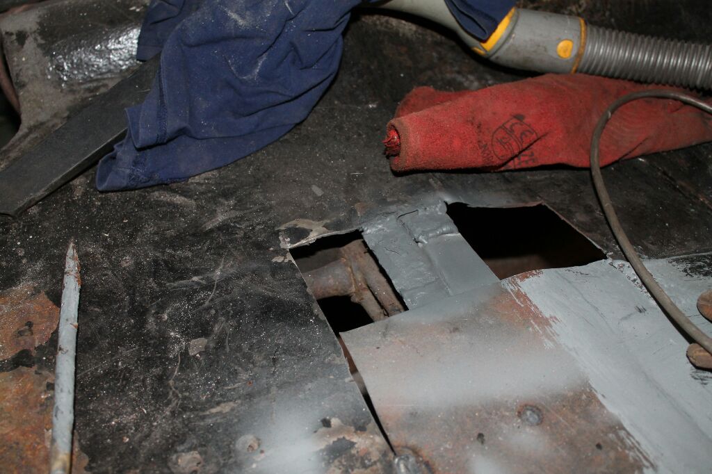

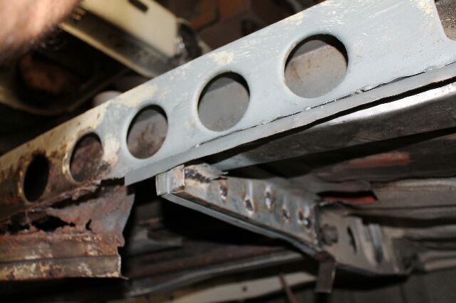

Been in Belgium for work for the last week so not much done on the cars, I bought some bits for the mx5 (new gearshift gaiters a big tin of waxoil and a fog light switch) mot is due on 9th august and we are on holiday the last couple of weeks in july so I need to get a move on sorting the fog light and leaking damper plus anything else I can find.
On the minor I managed to make a new end for the centre x member and fit it, just need to cut the slot for the torsion bar add a strip to the bottom and plug weld to the floor.
Next up will be the front floor / sill bottom which I am completely replacing. Then I will move up the a pillar.
