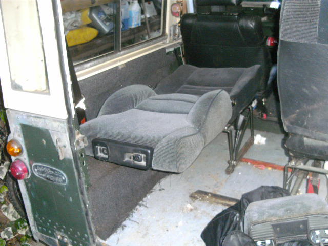

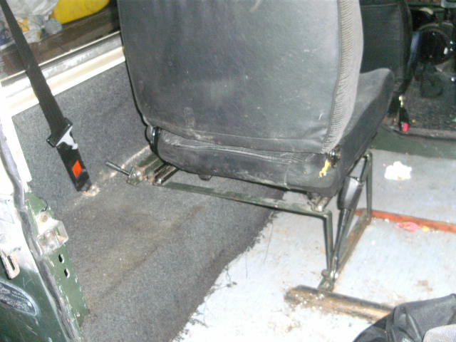

All the garden work has highlighted how much easier it would be if the landie seats folded out the way, exmoor trim do a superb set but at £700 they are way out of my price range, plan is to try to make something similar, first thing will be to find a pair of seats which fold flat and fairly slim, the plethora of 7 seat cars now around seems to help with this.

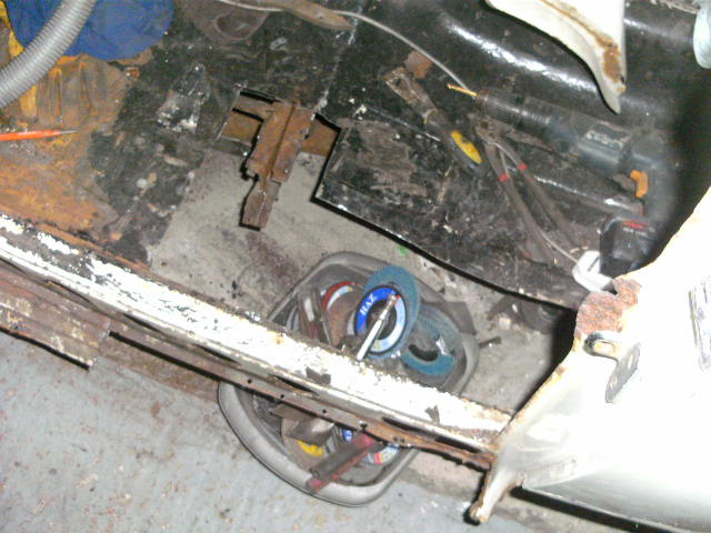

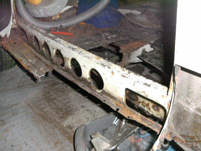

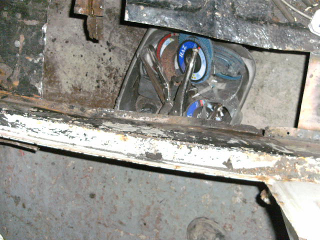

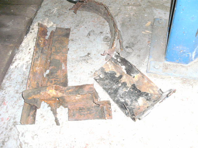

In one of the rainstorms yesterday I did manage a little on the minor, I cut the lower sill and floor edge away for the rear half of the passenger side floor. Most of it was supprisingly solid but there were a few patches it is one of those cases where it is easier to cut the lot out and start again, the inner sill and boxing plate a very good and just need a few local repairs to the lower flanges.
I have bought a complete set of struts for the mx5 (standard mk2 parts which I am told are interchangeable with the mk1), the front Bilstein one which was leaking is now knocking as well so these will have to be done soon.

There were the usual bodges though,

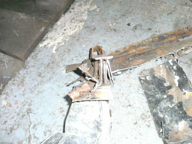

This is the end of the x member, there are only supossed to be 2 metal thicknesess not the 5 here!
The floor was also 4 layers thick in one place.
I also managed my own cock up, I have used all 50 of the thin cutting discs so I resorted to my 9" disc cutter which chomps through morris minor rather easily, unfortunatelly I did not even notice as I chopped the end off the torsion bar reaction arm!

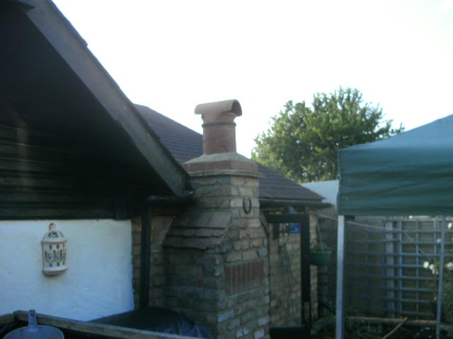

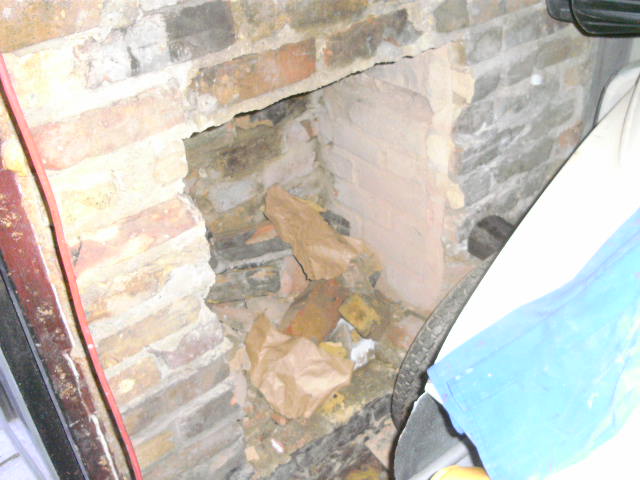

Phase 1 is complete and I am just laying the foundations for phase 2, there is one benefit from phase 1, the old chimney on the garage wall we used as a BBQ is redundant so I hae bricked up the outside and cut a hole on the inside, i can then have a log burner in the garage for the winter, I also have an old gas cylinder which will be used to make the burner out of, just need a length of flue liner and I will have all the materials I need.

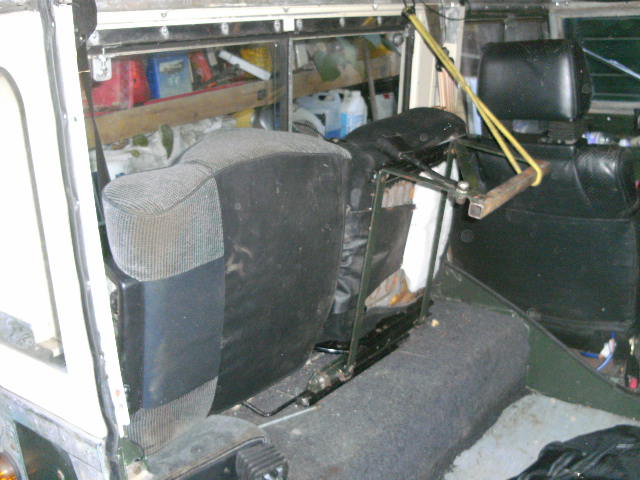

On the landie I fitted a new teflon lined throttle cable (bicycle gear cable) which has made a huge difference to the low speed throttle control, the old one used to stick then snap open, I have also been modifying the rear seats so the fold up out of the way. I looked at buying some seats which alrady fold flat but decided I was too tight to spend money on these, so I decided to modify the MR2 ones already fitted. Firstly I modified the recliner so the seat back folded flat , this involved cutting the upright off and re- welding it back on approx 40 degrees rotated towads the rear. Then I modified the outer mount to be a hinge using tube and threaded rod, to allowing it to rotate the seat also needs to slide further forward, so the outer mount was mounted on a old seat runner. This alows the centre fixing to be undone(one nut) , the seat slid forward, reclined then folded up. At so me point I will also make the centre leg fold down out of the way as well, I also need to fit a strap to hold it up instead of the bungee strap in the photos.
next step is to do the same on the drivers side.
For the MX5 I have re-fitted the standard air cleaner which makes it far more civilised and improves the low sped driveability ( a few minor stumbles when cold with the K&N) I have also bought new suspension which needs fitting before it's MOT in July as one of the front Bilsteins leaks.
