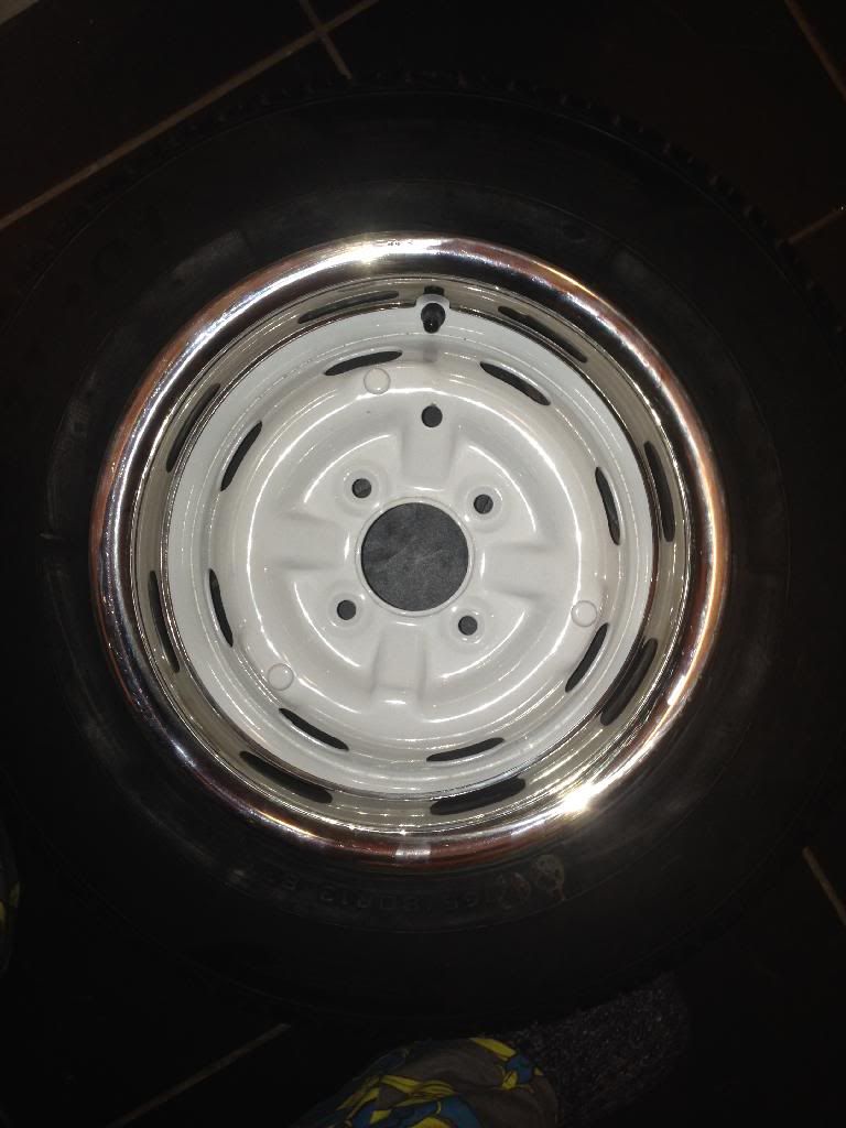

You will need to remove the powdercoat where the wheel nuts come into contact with the wheels otherwise your wheel nuts will work loose because of the lack of friction. This happened to somebody I know who powdercoated his steel wheels (he found out before he lost a wheel). I'm sorry if I've put a downer on it but it is better that you know beforehand rather than find out the hard way and lose a wheel with potentially disastrous consequences. It is a small price to pay to make sure the wheel nuts don't work loose and with the trims in situ it won't detract from the looks.
They're looking good though.

Thats a fair point TM, i have done about 6 or so sets of rims in the past with no problems. May have been lucky?

First rim (the spare wheel) was dropped at the fitters to have the plain black tyre fitted, didnt bother having that one balanced, the other 4 will be balanced though (fitting a tyre with a 16mm white sidewall band).
The spare wheel looks very smart indeed.
A nice parcel from a fellow forum member turned up today.
4 lovely wheel rim trims.
Not pressed into the rim, just sat on it to see what they will look like, should look quite smart with the chrome hub caps.
