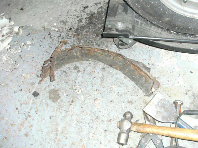

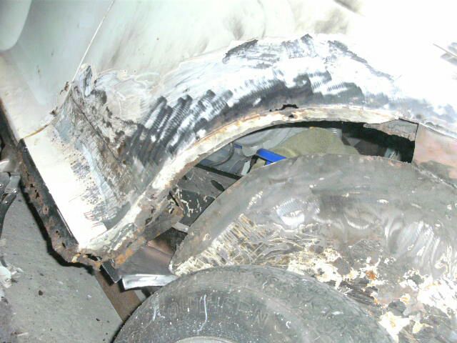

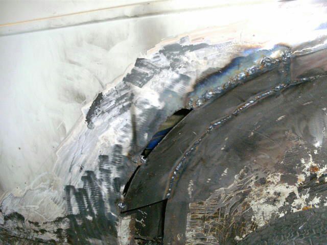

Did a little on the minor last night, cut out a rusty area in the rear wheelarch /wing flange, the usual combination of rust, filler and old patches.
I left the old wing flange in place at first to give me someting to keep the alignment, The patch being tacked to the old metal then cut it out and repaired the wing 3 inches at a time butt welding new pices in.
Needs gringing down but it was getting a bit late, I will also run a bead around the inside of the corner for further strength.

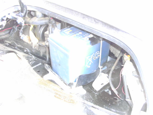

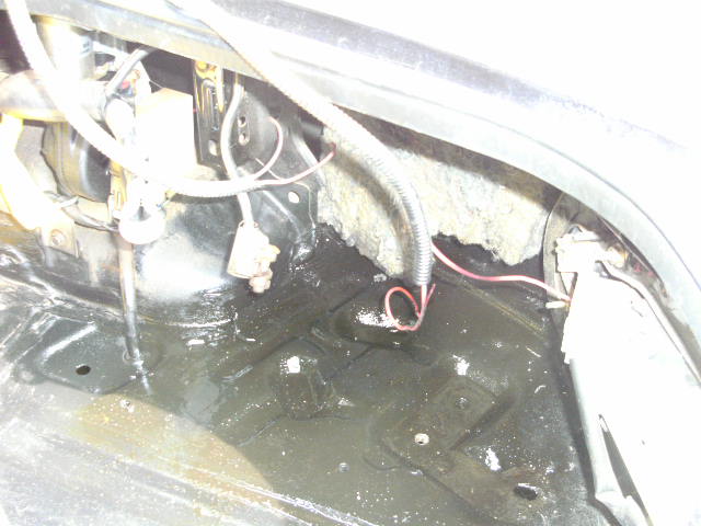

Did do a couple of little jobs on the mazda, the battery has never been clamped in properly, someone had tried to wedge it in with some bits of wood and a bolt, but it was still loose. So I bought the proper clamp but also decided I would remove the battery and clean up thge area around as it seemed a bit rusty and marked withed acid stains. It was only light surface rust where the battery had been moving and worn the paint it cleaned up easily enough and it was given a coat of rust converter followed by zinc primer, then black stonechip and finaly some wax this ended up looking like this
Next up the battery was cleaned and re fitted on a piece of pond liner to try to protect thed floor, I don't think it is the right battery though as it has no external vent and is too tall for the clamp which had to be lengthed.
I have a old battery with a vent somewhere, I may try drilling this one to fit it as this would make sure the majority of fumes end up outside.

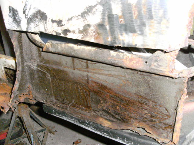

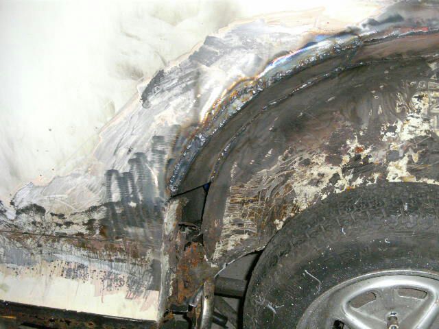

In frustration I set to minor with an vangle grinder, the result:

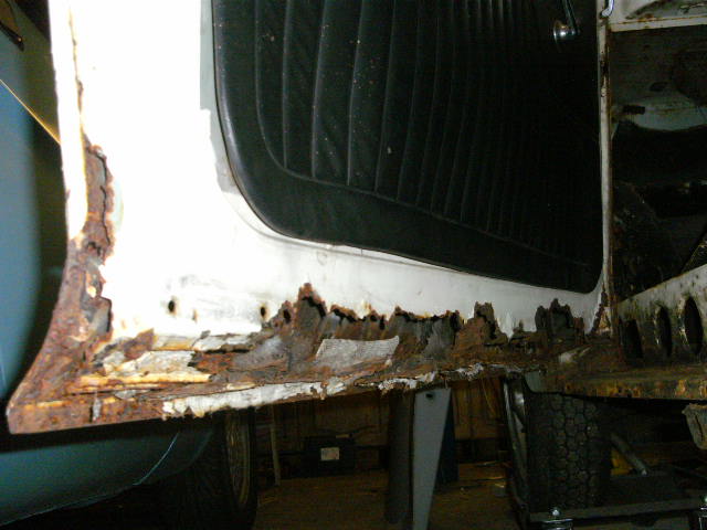

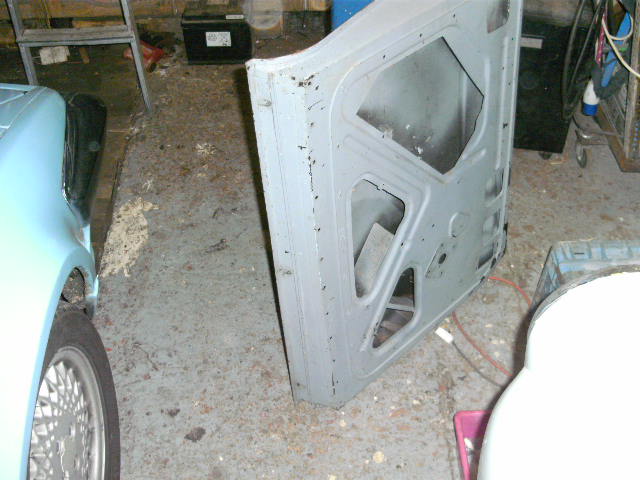

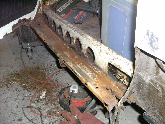

I also took a look at the door, thge intention was to repair it but a bot of poking ended up with this
After a few weeks searching on ebay I found this locally for £20 which should make life much easier.

#147 Post by TerryG »
Something good came of your washing machine drama then :) It looks like you have quite a bit of metal to put back in but at least it isn't completely rotten. I have sat in one that was in a breakers before for the floor pan to snap across the passenger side!
