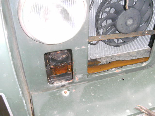

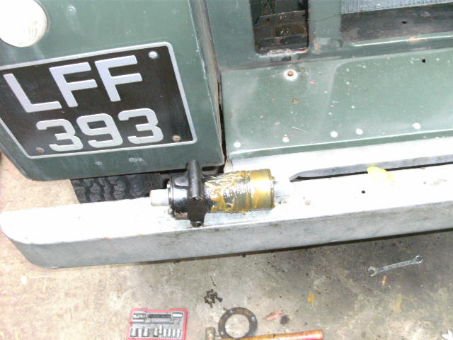

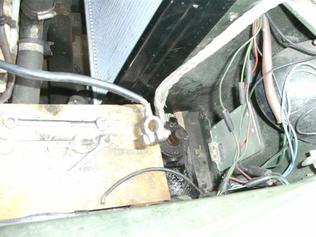

Did the landrover steering relay today, battery tray steering arms etc were fiddly but came off easily enough
Then I removed the bottom retaining ring to reveal a rusty mess, my first thoughts were this is never going to move. Used a selection of 3/4 sockets and extensions to jack it up from underneath, front wheels off the ground no movement whatsoever.
So I started hitting it from side to side using a chisel wedged between the chassis and relay.
Lo and behold it started to move, after plenty of knocking backwards and forward it eventually started to move up, the rusty liquid Is all the wd40 I have been squirting down the side.

New one and the hole were heavily greased.
Which then slid back in with no problem, another half hour or so of assembly and the job was finished.
Driving it the difference is amazing it feels like a different car the new relay has reduced it from 3.5 inches to half an inch play at the steering wheel, it's almost got steering feel!
