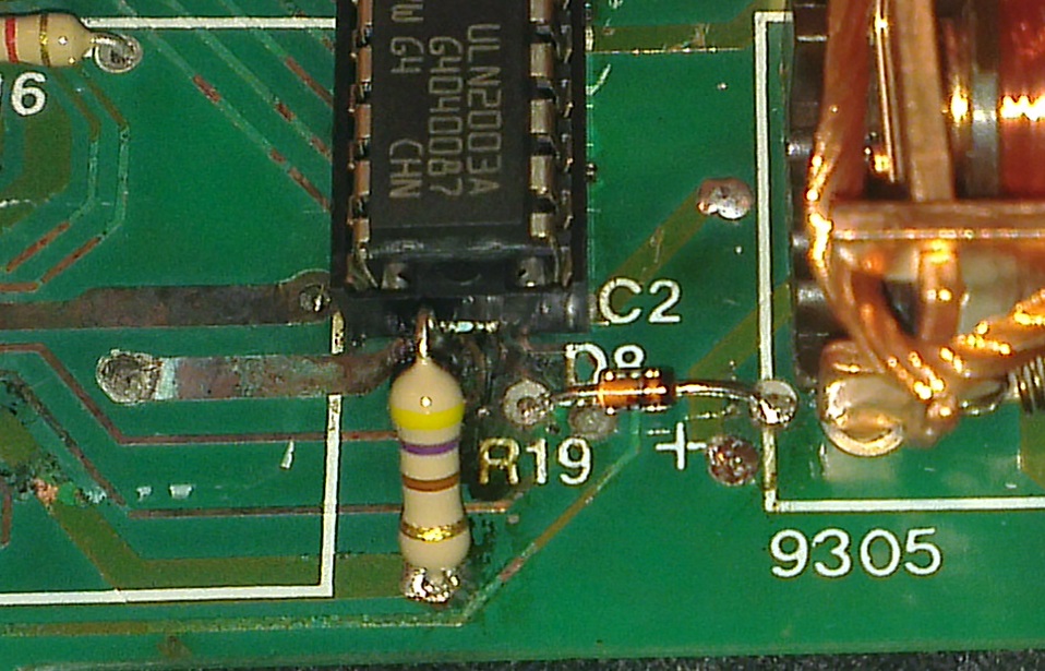

A few pounds (for enough parts to fix 10 of the damn things), 20 minutes with a soldering iron, some scrubbing to get as much "burn" off as i can and.....
TADA!
The PCB itself is black but all the tracks are good. Fingers crossed it works again! I collect the car back from the MOT place tomorrow (hopefully with a new ticket) so will test it then :)
Re: 1994 Range Rover
#125 Post by TerryG »
Well, I'm moderately irritated. My repaired ECU doesn't work :( I have compared every line local to the damage with my other ECU and they match so definitely not a problem with the PCB itself. All the relays test OK. After a really close look, there is a small black mark which is just visible under the "computer" so I suspect that it may be scrap :(
On the plus side, my spare "faulty" ECU is now repaired and working fine so I can adjust the seat again. Just as well I didn't think about fixing it a few years ago as I would probably have sold it and now I would be stuffed!

The broken one will take residence in the box where the "faulty" spare has lived for the last few years. I'll keep my eyes out for another faulty one as normally the problem is a leaking battery eating it's way through a load of tracks on the PCB. The "computer" is far enough away not to be affected by that so I should be able to make one good one from the two.

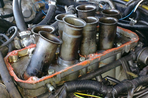

I have taken my intake apart in search of the cause of poor idle when hot.
Looking at these, I may have found it
One of them has rattled loose and was so high that it was rubbing against the top of the plenum chamber!
I was able to pull all 8 trumpets out (not difficult as 3 of them weren't actually in!) by hand, no heat required so I will put them back in with some liquid gasket to hold them in place after I have given everything a good clean.

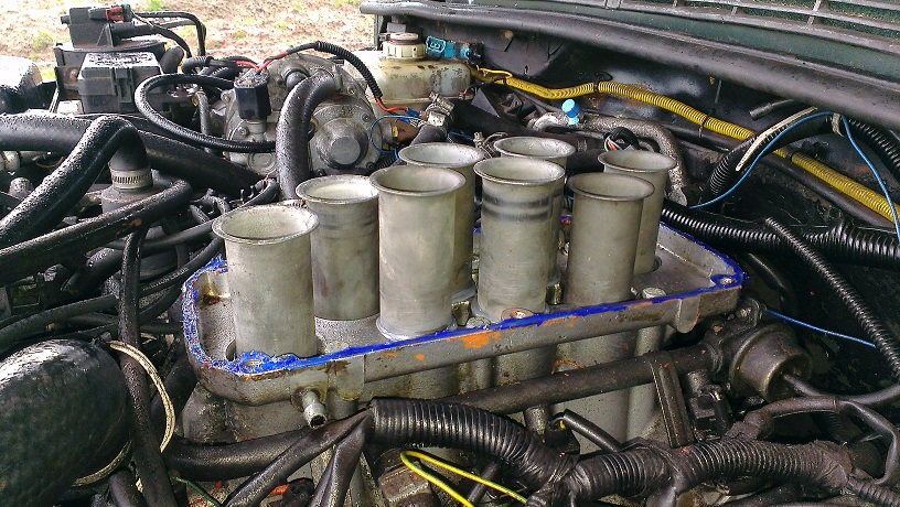

It looks a bit better after a good clean and having the trumpets epoxied in place.
Still have a problem with the oil pressure light flicking on when putting the car in drive when it is hot. the Idle drops down below 400 when it happens so I have ordered a new idle air bypass valve as the one that is on it works fine but may not be reacting quickly enough to bring the RPM up and stop it trying to stall. I wouldn't mind but this has happened before which lead to me replacing the oil pump only to find it was a bent butterfly. "unfortunately" this time, it is fine.
