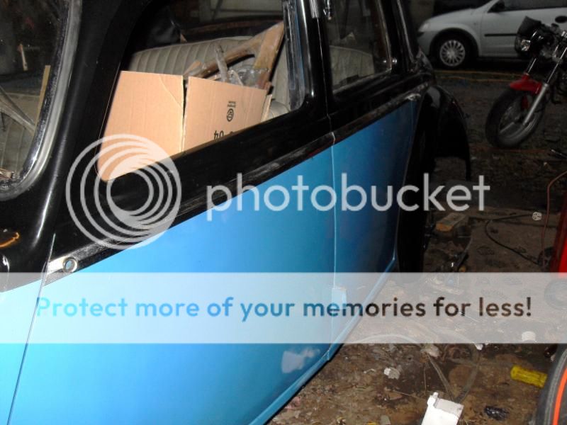

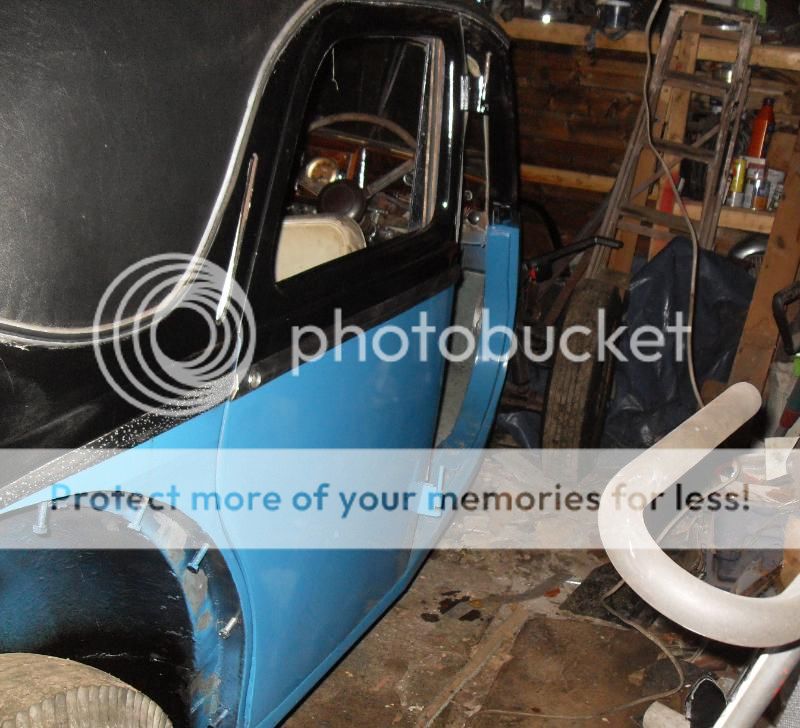

So, passenger side doors on, the back one has been trimmed up with glass etc, the front will have to wait until I can order up weather strips etc.
Rear drivers side door is also repaired and fitted, again it needs trimming up with glass etc, ignore the poor looking fit in the photo, the catch isn't on yet and its just pushed to.

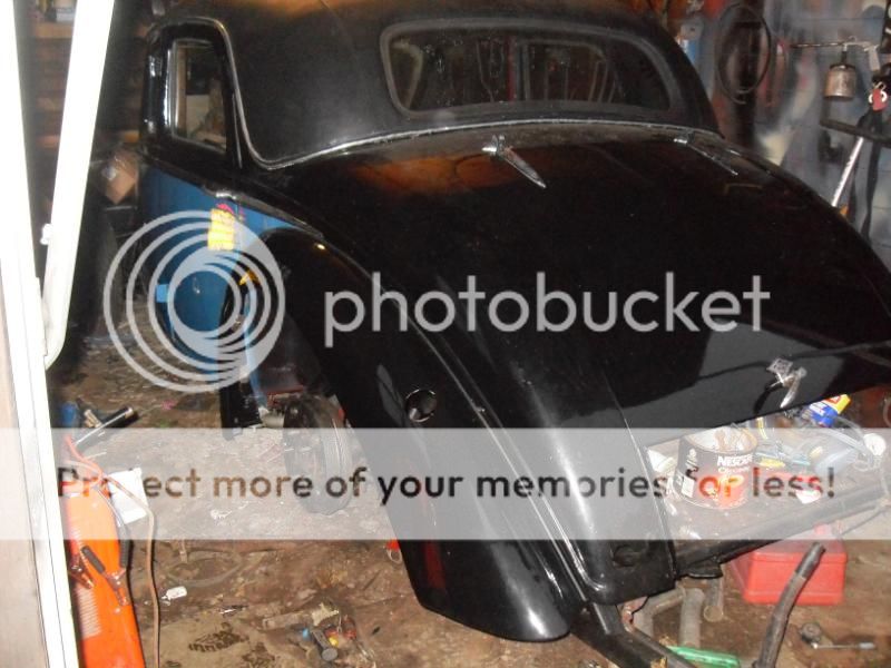

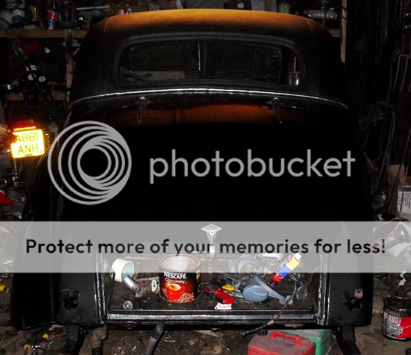

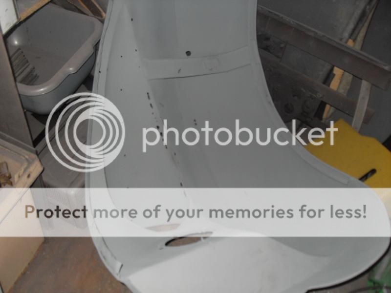

I got the wings and boot lid back from the chap who was shotblasting them, deciding it was easier to store the drivers door than the wings I diverted onto wings and boot lid.

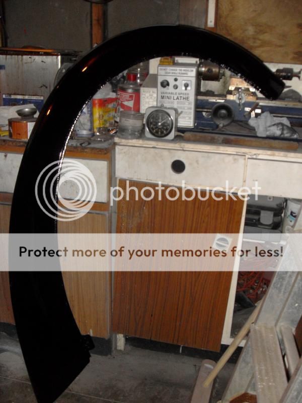

Ive repaired the ravaged edges of the rear wings, and after much sanding, filling, sanding, painting, sanding (you get the whole soul destroying, mind numbing idea) I have the passenger rear wing and bootlid on.
Offside rear wing is now in paint and ready for fitting

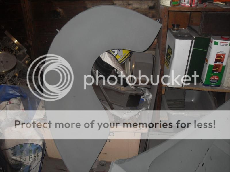

so the front wings and rear spats are awaiting attention, here they are, lots more welding, sanding, filling etc to go.
Rear wing spat

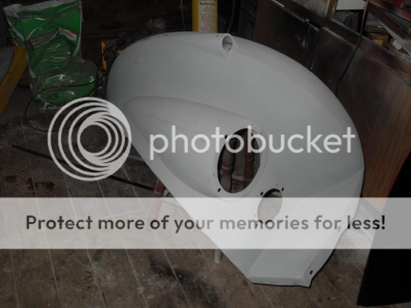

The better of the two front wings needing only minimal welding, but has a lot of old dents and plenty of rust pitting to sort
The offside front wing, this has a lot of ragged edge to deal with along with a lot of small corrosion holes along its joint seams to be dealt with as well as the pitting and dings
Rear wing spat
