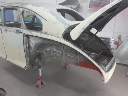

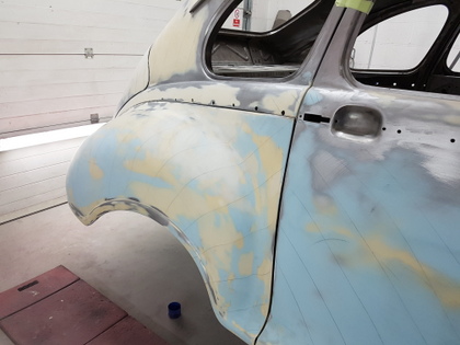

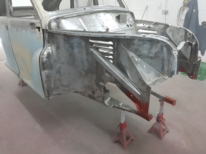

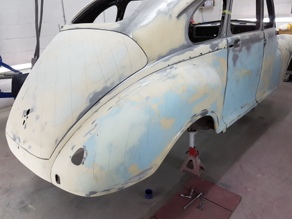

More done today - so rear shrouds & upper edges of both rear wings profiled - refitted the wings for final fitting check - the joining gap is hidden by a piping bead once the shell & panels are painted

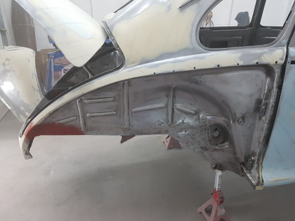

Then rear wings back off and inner rear wing areas prepped for paint - primed the area that bumper irons mount to so they can go back on in the morning and the bodyshell can then go back on to the chassis tiliter to allow me to rotate the shell and access the underside of the chassis for prep & paint
#104 Post by Grumpy Northener »

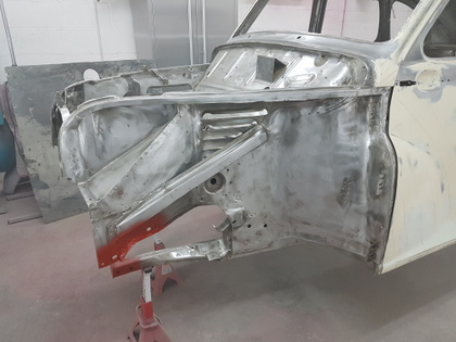

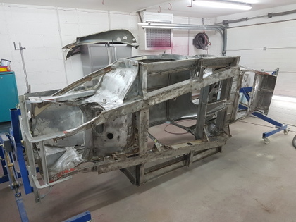

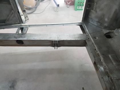

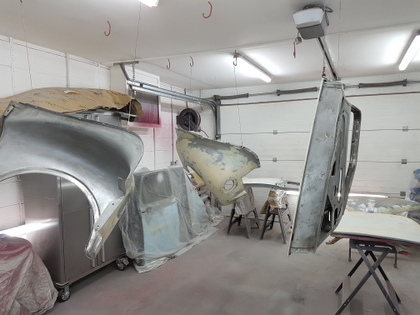

Front wings off to allow for prep of the underside of the panels along with the inner wings & bulkhead area, again I primed the bumper iron mounting areas in advance of refitting to the chassis tilter - then spent an hour or so vacuuming / blowing out the two chassis box sections (loads of debris in them) - doors can come off in the morning prior to rotating the shell over and prepping the underside and there is about an hours work sorting out a weak panel area adjacent to the offside rear shock absorber mounting

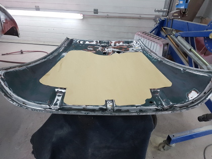

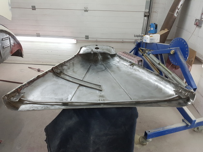

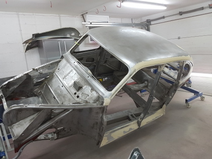

Back on to the tilter - and over to complete the last of the profile work on the nearside roof edge / gutter channel - meanwhile the underside of the panels were prepped - bonnet & boot - took the opportunity to template the boot liner for the inside of the lid which will be cut from milboard

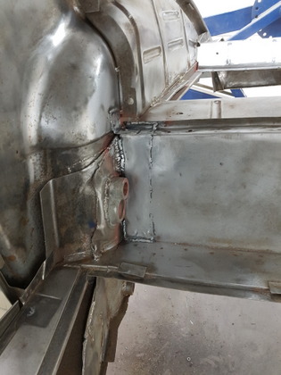

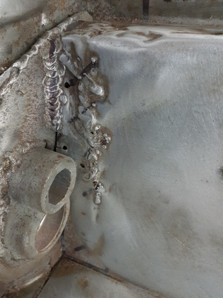

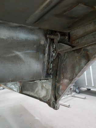

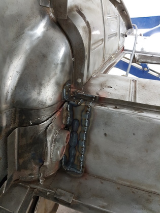

Last of the welding :o - this is the rear upstand to the back seat but immediately to the rear of the dodgy looking / hacked panel is the rear upper shock absorber mounting which are a weak point on the car - so cut it out - replated, strengthened and cleaned back

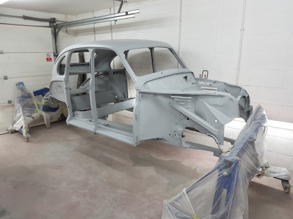

The all the way over on the tilter to clean & prep the underside ready for primer - and not quite on target has I had aimed to get the polyester on it today - however it is ready to go - just a quick clean up in the workshop in the morning and I can start to coat it up :thumbs:
#108 Post by Grumpy Northener »

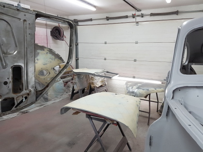

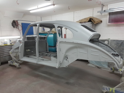

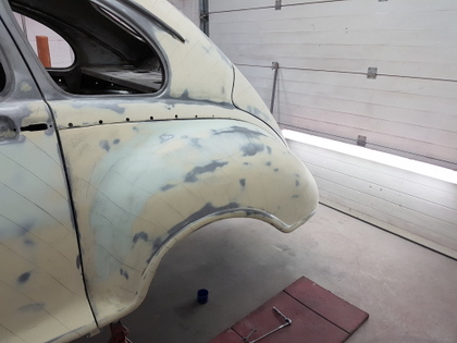

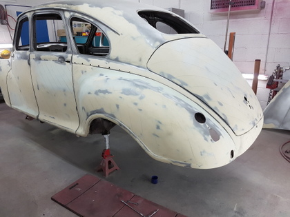

So shell now in polyester spraying filler & several panels coated up this evening - just leaves both back wings & both offside doors plus a load of minor parts to get to the same stage tomorrow

#109 Post by vulgalour »
Well now it looks like you've not done anything to the shell at all and it's just been made. Sign of a job very well done is that.

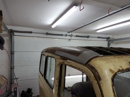

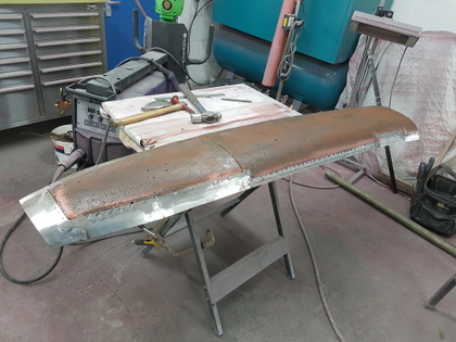

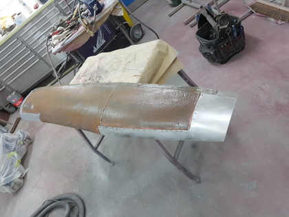

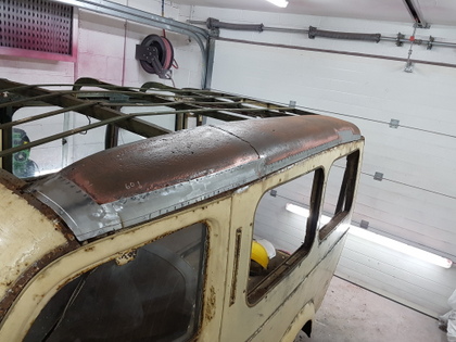

Meanwhile I have the owner of the Bradford due with me on Monday to deliver some parts - so I need to make it look like I have done something - continued with the roof radius panels - repaired & trial fitted - edges shrunk and trialed again
