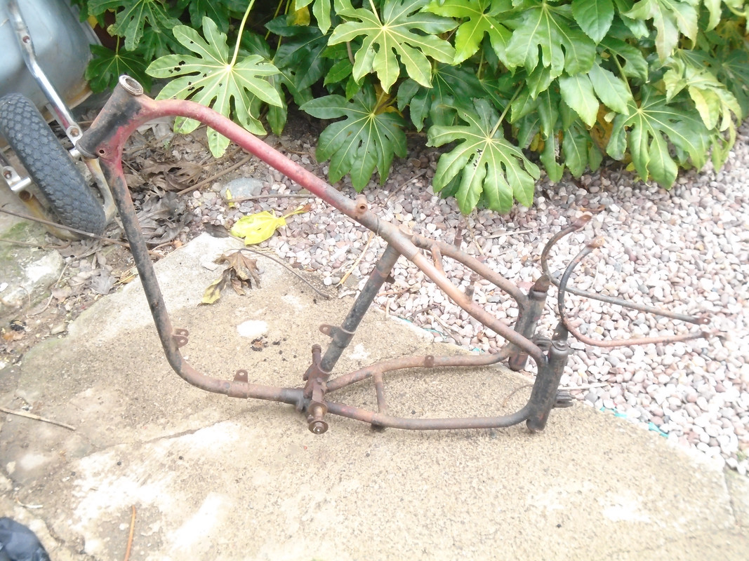

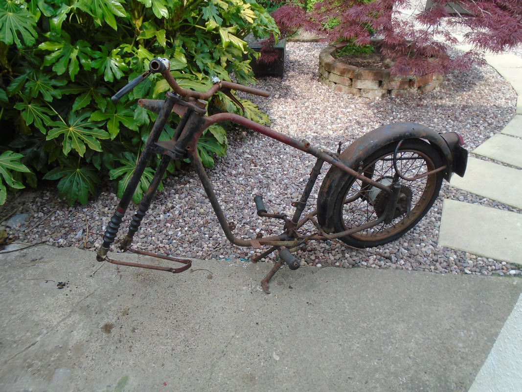

Anyway, life, lockdowns and all manner of troubles saw the bike stuck in Caithness until spring of 2021 when it finally arrived outside our house on a trailer with my Son, his fiancee and our first Grandchild attached..
So I pulled it apart
At least there isn't much to it so that simplified things, I don't really have photos of all the scraping, sanding and grinding that followed, its safe to say I should have just sent everything for blasting but wheres the fun in that.

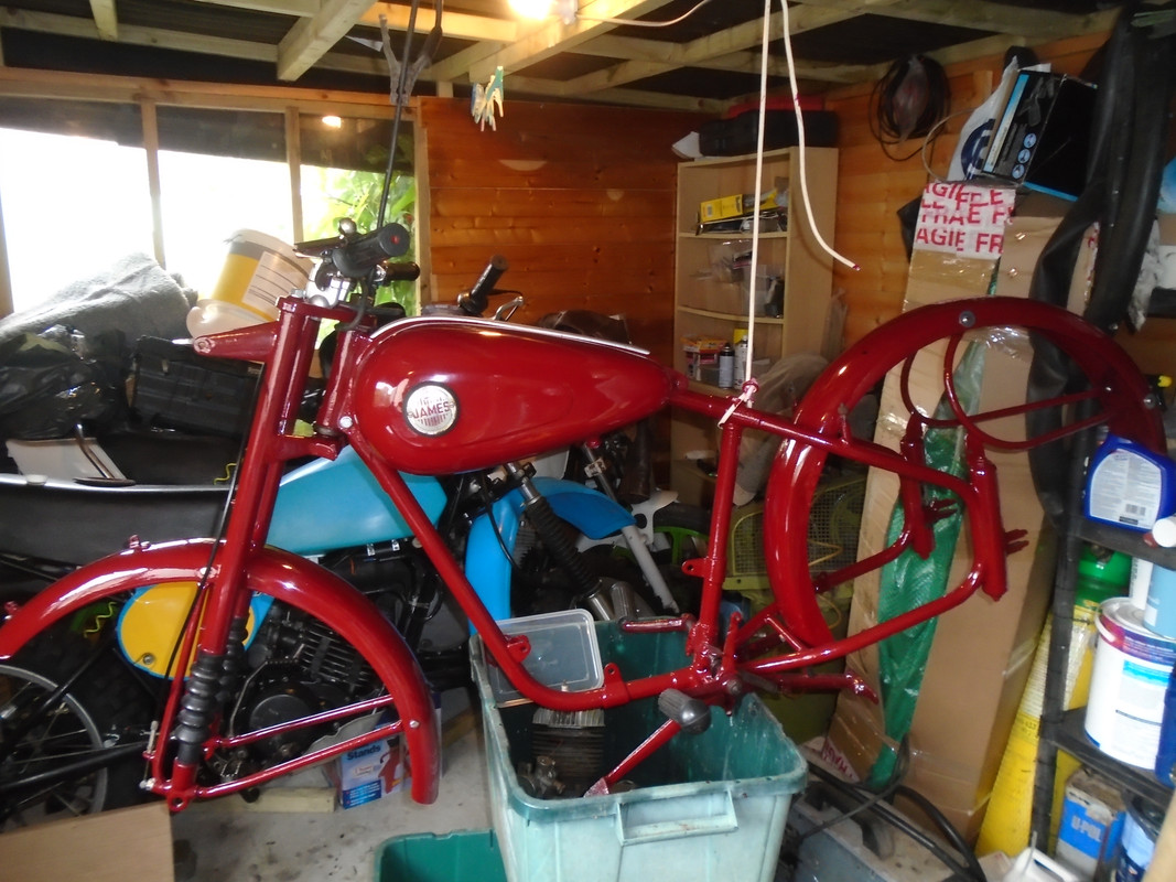

Soooo..... lots of scraping and sanding later I started painting and reassembling, lots of new bolts of the correct size and pitch were used, paint was a coach enamel which even though brushed went on really nice, on the downside I'm going to have to attend to some areas again when my next project is done due to some micro bubbling problems that have arisen.
I'm putting the paint problem down to an industrial rust converter primer as its only happened on the areas I used that, its still not bad though so I'm living with it for time being.

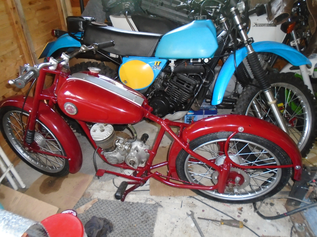

Piccies ...
In the background is another small project I had, a 1978 Yamaha IT175, American import with only a few miles on the clock and even the original DID stickers on the wheel rims, sadly it had to go to help fund a car for the missus :( There is also a Z1000 hiding in the background but sadly that was just a bike I helped flee the wild Far North for sunnier climes in Kent..
Imagepic sharing
New fork gaiters were found, luckily they are the same as on early BSA Bantams so easily sourced.
All bearings were changed, the front hub uses cup and cones with loose balls like a bicycle, at some point someone must have had a couple escape past the cup as I found them in the hub along with some interesting scoring of the wheel spindle, they must have been there a long time for sure.
And then she was almost back together, fortunately the wheels were never chrome and had an "Argentized" finish which is close to to wheel silver so that simplified things, the handlebars were very crusty and having integral mounting lugs presented more of a challenge, so Bantam bars and some cheap bar risers sorted that quite sympathetically.
A set of moped tyres from Germany was the cheapest way to give her new boots that look of the era, and then she was back on her feet and looking more like a motorbike again, I'd even sourced an engine and carb by now.
More soonish :)
