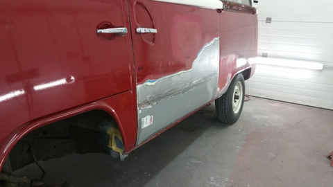

1973 VW Camper for full two tone paint job - several panels + welding / making good prior to paint - currently on with the worst panel - side loading door - bottom of the door and lower of the outer skin is dead and been the subject of several pervious failed repairs
I get really pi**ed off when I find filler in excess of an inch thick piled over the top of a dent / scrape because they can not be bothered to remove the inner door card and dress the damage out

Just lazy bodgers ! - needless to say I have now dressed the scrape out now - took all of a few mins
old door bottom & skin removed
lower skin & door bottom tacked / trial fitted

Now fully welded and dressed back - ready to rehang tomorrow in order to recheck alignment - it then has to come back off so that it can be prepared for paint
