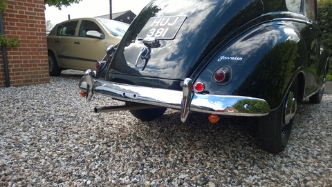

Javelins were only fitted with semaphore trafficators in the B post at the factory and HUJ still retains them however, most owners have added indicators to the cars over the years - the fronts are straight forward by using the separate side lamps as indictors (white lens but with an amber bulb) then fit the sidelamps into the headlamp bowls - this was sorted when I first acquired the car last year - the rears were some make do & mend attempt that the previous owner had bolted on - Something that I never liked - I wanted something that was less obtrusive and that did not stand out on the car too much - again these were sourced from the NEC show and duly fitted
Result was a lot better in appearance

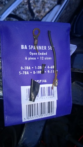

Next on the list was the flickering charge light on the dash - no surprise then when I found this lot on the rear of the dynamo
Bits of bodge / tape and a loose connection - quickly put right by cutting it out and extending the cable
