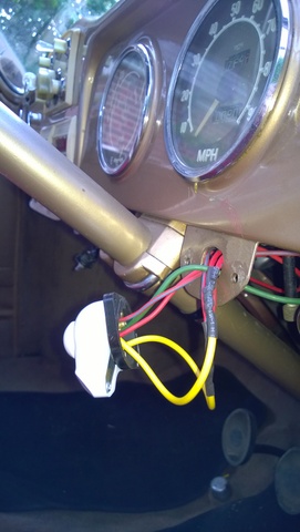

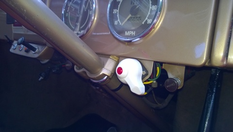

These were replaced with new old stock arms & blades that I had managed to pick up at the NEC last November - next on the list was the broken indicator switch again I had sourced a new one at the NEC show - I had to sort the wiring where the previous owner had stuffed 3 wires into one terminal - soon sorted by soldering the three on to one lead and making good with some heat shrink
The old switch was cream but the new identical Lucas switch is bright white - something that I will have to live with for now while source something more suitable in colour

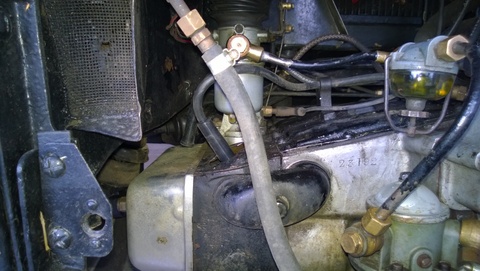

Next on the list was the flickering charge light on the dash - no surprise then when I found this lot on the rear of the dynamo
Bits of bodge / tape and a loose connection - quickly put right by cutting it out and extending the cable
