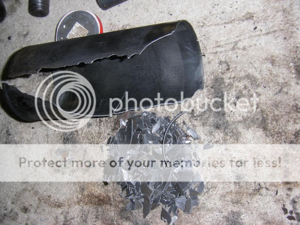

If memory serves, they were "chrome liners" on these engines (and later 35/35X) - this is how my friend came a cropper with his earlier 35 (Partco offered him cast ones)!
As it's an AD3, it's direct injection (the injectors go in on an angle to squirt into the centre of the combustion chamber) - these were introduced on the 135s - 35/35X were indirect injection.

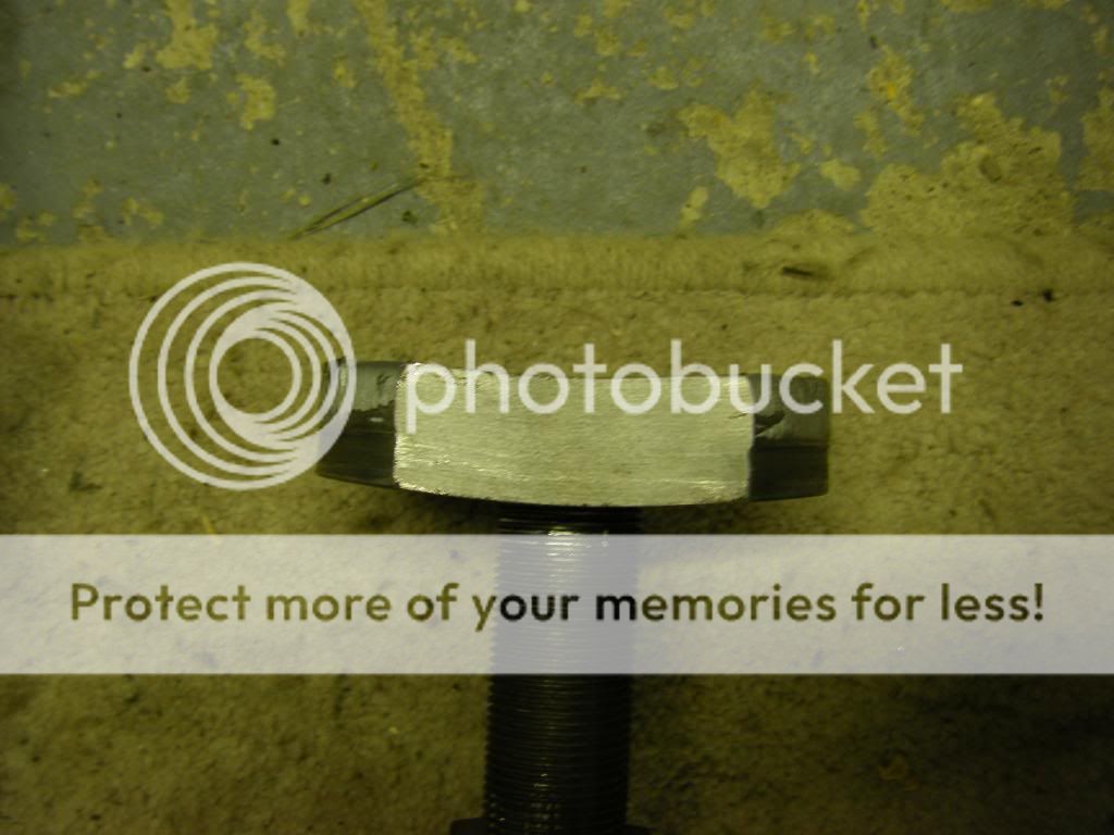

IIRC, my friend had to borrow the special tool from a local agricultural mechanic to get the liners out of both his 35 and 135. I didn't see him to either machine, just heard the long and boring stories (almost bolt-by-bolt!)
