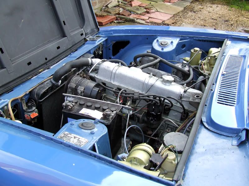

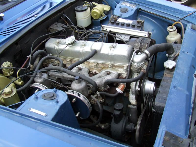

A new red rotor arm arrived yesterday, so I'll fit that over the weekend, and see how things go from there.
I must admit the fuel pipe looks a bit Heath Robinson from the pump round to the carbs,
Copper?? pipe from pump, under alternator then over top of stat housing,
then to rubber hose, filter, rubber hose, and yes I know there are no clips on the pipes, it's on the to do urgently list!
There's an earth strap running from the coil mounting bolt on the block to the battery already. I did think some earth braiding had snapped looking down in the depths of the bay, but once I got under it I found it to be remnants of a snapped alternator belt.

Do the changes one at a time otherwhise you may get the car running better but be none the wiser at to what you have done to improve matters. I don't like the way that fuel pipe is routed over the engine right in the flow of hot air. I would reroute it around the engine bay, under the rad and then up to the carbs lessening the likelyhood of fuel vaporisation

That's pretty much how Triumph routed the fuel pipes- my Vitesse is similar, the only differece being that it runs in front of the thermostat housing rather than behind, so I don't think vapourisation is causing the problem. I'd be inclined to replace the flexible bits of the piping if it's of unknown age or origin.
Just because the coil is new doesn't mean it's not faulty- it might be an idea to drive the car until it happens again, and then whip the bonnet up quick and check for a spark by pulling off the centre lead from the dizzie cap and earthing it against the block, and also check wether fuel is being delivered-pull a pipe off and check if it squirts when being cranked, that should narrow it down a bit as to where you should be looking (obviously put the lead back on the distributor before you do this, sparks and petrol occuring at the same time should be kept inside the head, not outside :lol: ). The rotor arms tend to just fail and not work, they don't go and then come back but anything Lucas boxed is on borrowed time so it's worth fitting the new red one anyway.
