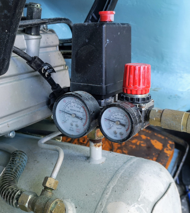

My compressor has a very similar switch unit to yours ... that pull-up red knob .. but how do you get it off (without breaking it!).
My compressor came with a ridiculously short cable which means an extension trailing around most of the time .. I'd like to take the original cable off and replace it with a longer one so I can store the unit under the bench but still have it plugged in .. I know I could put another socket under the bench closer to the compressor! I mounted all the sockets in the garage fairly high up the wall to make them accessible and away from car doors, etc before I knew how stingy the manufacturers would be with power cables ..
But I can't see anyway into the switch box .. not that doesn't involve a lump hammer anyway!! :?

The knob doesn't need to come off, it just presses on a plunger underneath it. Remove the one screw in the middle of the lid then the whole assembly should come off with the knob still attached.
I should have been braver!! Many thanks!!

It probably would have had me scratching my head for a while if the old Danfoss refrigeration pressure switches weren't put together the same way...so I went in armed with useful prior knowledge.
