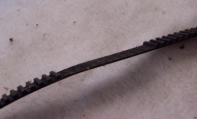

#7 Post by gazza82 »
Din;t need changing?
Tell that to all the owners of A-Series engines with rattling timing chains .. because they have stretched ..
OK less likely to break than a belt but then again belts tend not to snap but the tensioners seize and take the teeth off .. just like this in fact ..
