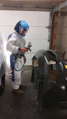

- Nope - it's a if you want spray 2K products and stay alive then you need to wear the correct personal protective equipment (PPE) - I rarely use 2K products but when I do - its a full disposable suit, a air fed / positive fed full face mask - you should also be spraying in fully a ventilated room or booth with a system that is capable of exchanging the air volume held within that room / booth several times over per minute which should be filtered intake - filtered extraction - and once you have the said air fed mask it's not just a matter of plugging it into the compressor air supply either - the air to the positive fed mask should be routed through a 3 stage separator first - next time I have the gear rigged I will get the other half to take a pic of me in the required outfit and post it on here.

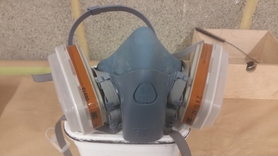

FOR THE AVOIDANCE OF ANY DOUBT - if anyone - anywhere in the world is spraying / applying a 2K / 2 pack / Isocyanate based product whilst thinking that they are protected from the spray vapour / fumes by using one of these (or similar non positive fed respirator)

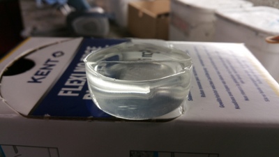

Then they will not be living for very long - isocyanate based automotive refinishing products are not only poisonous but they set as a solid substance like this
(clear lacquer taken from mixing cup once set) - Non positive fed / air fed masks will NOT prevent the spray vapour / fumes from entering into your lungs - this then sets solid with a net result of sealing your lungs. ONLY this type of set up that I am wearing in the image is to be used with isocyanate based products

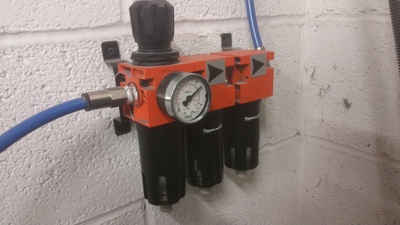

- further to this the breathing air feed from the compressor should be a proper 3 stage coalescing filter
