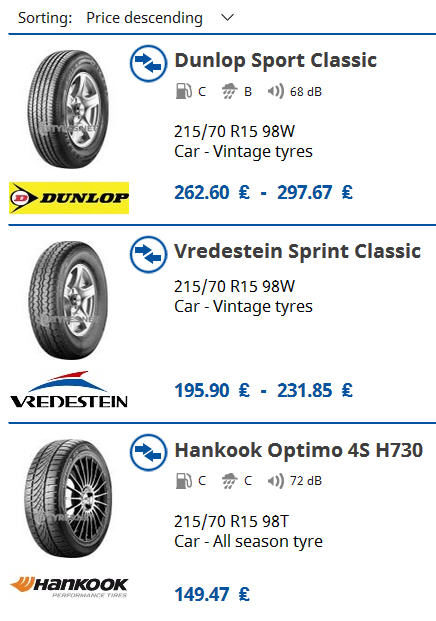

Found this site on another forum recently .. seems to be links to suppliers as you find the tyre you want. Has a few options if you search down past the ditch-finders. I've also used TyreLeaders in the past and get a local fitter to do the deed .. for a "contribution to their Xmas party fund" .. ie cash in hand

Oops ... didn't think of speed rating ...
That's the thing...there are a plethora of 215/70R15 tyres out there - but that's because it's a common van tyre size nowadays...so 99.9% of the results are van or 4x4 tyres if you look carefully.
The pricetag is usually a giveaway too! If they're correct they're £200 or more each!

There were some expensive ones .. maybe not in that V rating though ..
Drop down to T and there are a few more under £100 each
Or look for S and get White Sidewalls!
Think I need to be careful of the speed rating as tyres are one of those things that my insurers state in their paperwork must be maintained to the original specs - so V rated it is.
