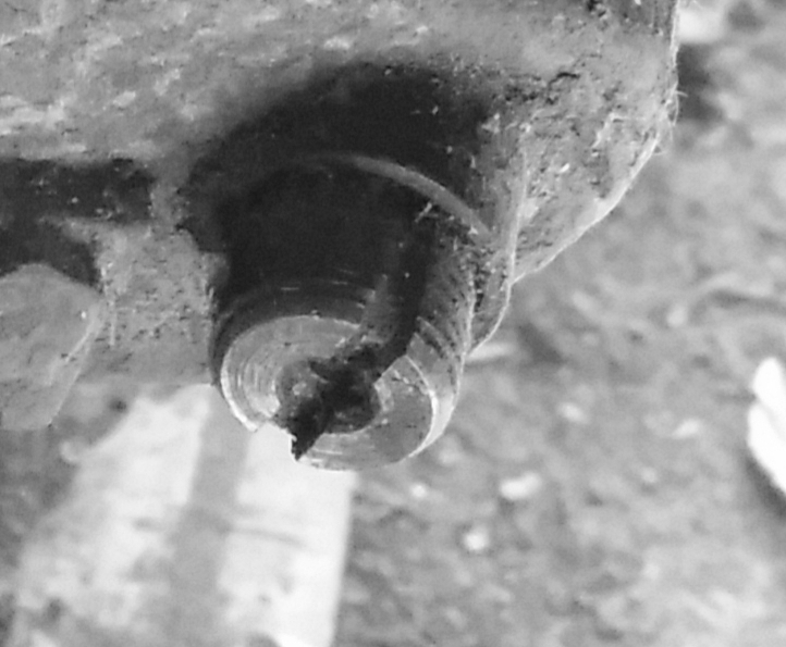

I started to take the front suspension off yesterday ... well actually I went looking for the long bolts/thumbnuts as Iwas planning to do this tomorrow. So I spent a few minutes getting the nuts to run up and down the bolts. One kept jamming so swapped them over and they both work now .. plus a good clean with penetrating fluid ..
But then I put them in place, removed the two remaining spiring pan bolts and sort of got carried away .. so one spring is now out and the other will follow tomorrow I hope along with the suspension arm/kingpins/tub axles/brakes/shocks/steering arms as planned Then I can get the steering box and idler out next.
Anyway, back in the 80s when I swapped over the suspension for A40 Farina 8" brakes I must have had it in my brain that this was a temporary fit because ...
That is the lower fulcrum pin and should be screwed right into the suspension arm/pan bushes!!
[And that is the daftest design ever as when the suspension moves up and down that pin rotates in the bronze threaded bush as the kingpin is 'pinned' in place on it .. and so it wears into the bush .. sometimes to the point that you cannot actually remove the old fulcrum pin because the step is too wide and there isn't anything left to screw on to. Many resort to angle grinders at this point and cut through the pin either side of the kingpin. New suspension arm/pan and new fulcrum pins. Luckily I have two good "used" arms to go on but I probably will need two new fulcrum pins/cork seals/etc.]

Finished removing the o/s suspension .. that fulcrum pin did screw in further but the threads were very dirty ..
