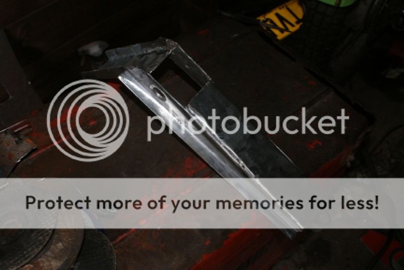

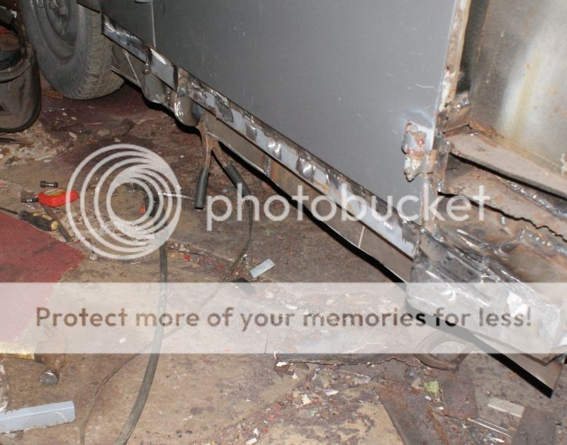

Right, I may be about to be arrested for crimes against classic Austins, but i have taken Johns careful explanation and drawings and arrived at this bastardised version.
I first made the sill nose piece, then started adding steel to form a box along the sill attached to the top step, a bit more steel required on the box under the center door post and a little more welding to finish but I think you will get the idea.
I'm sure it is a little rough compared to the slides John has seen, but I think it has added the requisite strength, well, I hope so.
At least the doors still fit, well they do now I have taken a hammer to the bottom hinge at the A post

Re: Austin A30 Seven
That looks absolutely spot on!
Well done man, at this rate you'll be finished by next weekend.

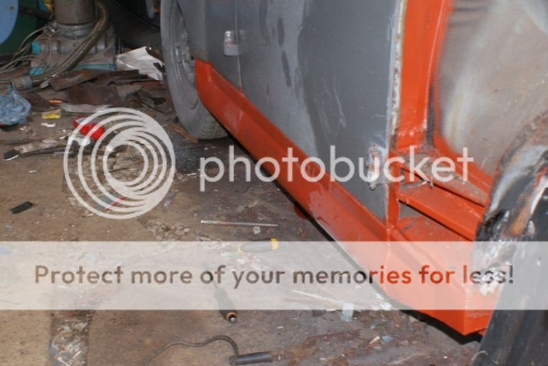

I finished the inner sill sections then got the outer sill on, it's a cheapo length of metal just cut straight through with no closers on the end that needed a lot of fettling to fit but at £44 + P&P a lot cheaper than the real thing. I shaped the rear into something like what should be there and a skim of filler should have it looking ok.

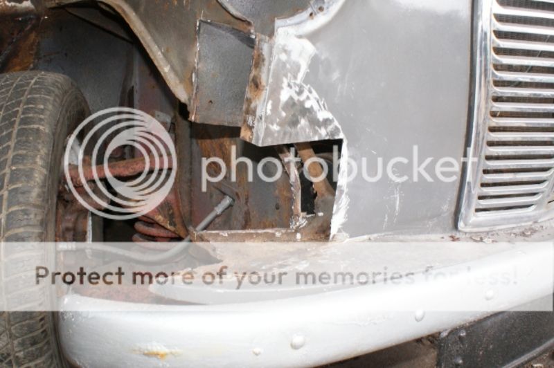

I've also done a bit on the inner wing replacing rot in the door hinge brace, and cutting out the patch that formed the edge of the wheel arch so I could butt weld it rather than it be lapped over the rusty metal. I'll revisit these areas with a flappy disc to tidy things up before I stone chip the inner wing.
There were patches at the front of the inner wing and on the front panel, these had been done quite well and I was tempted to leave them be but as they were again straight over the top of rusty metal my conscience wouldn't let me, so, more cutting out

I finished the repair to the front panel and inner wing then cleaned things up and stone chipped this area

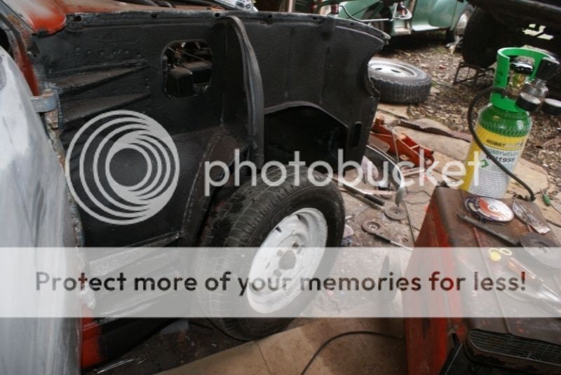

All good there it was time to get to the front rear spring hanger and associated areas. Horrors as expected awaited, silly little patches that were just hiding things and good metal took some finding.
Metal and rust dissapeared over a largish area, full removal of existing spring hanger
including the inner arch and shock damper mount
More metal disappeared though I didn't photograph that, but basically a chunk of floor and the front section of the inner arch next to the damper mout area shown.

Which meant I could start trying to build up something similar to the original structure so a new bit of inner arch / damper mount etc went in, it needs grinding back to tidy but I've protected it for the time being and will come back to it
Spring hanger, some floor and more metal from the inner arch to tie things together, forgive those scruffy welds please as I couldn't get the torch in where I wanted it but everything is glued nicely
