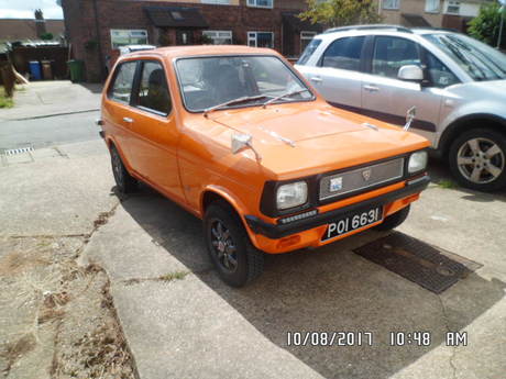

As a contrast, I simply have an 848cc (Reliant Kitten), but the mileometer is now well into its 6th lap (in my long ownership)!! I did have the engine professionally rebuilt by Hans Kirama about 5 years ago though, to a much higher state of tune than standard.... Also had the chassis galvanised and modern disc brakes, servo, poly bushes and gas shocks so it's now well capable of keeping up with "moderns" in daily use. Last rolling road session it was doing 40bhp at the rear wheels plus 60mpg at 4000rpm / 70mph, not at all shabby for a car that only weighs half a ton..... Standard these struggled to do 40bhp max at the crank.
