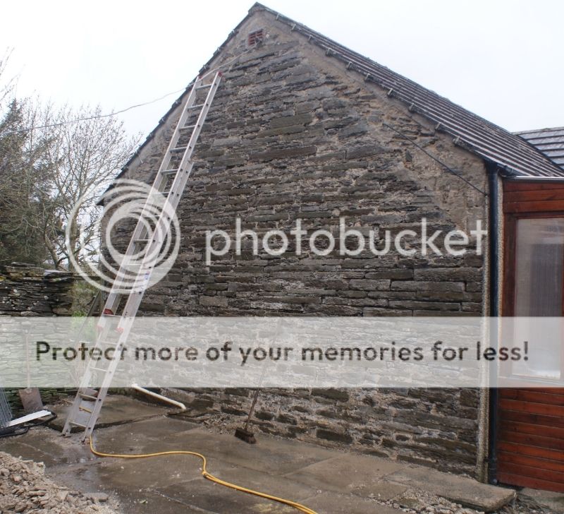

I've uncovered the first wall but still have lots of raking out to do, some comes out easy but some is very hard and difficult to shift.
An alteration to the roof line is now pretty clear.

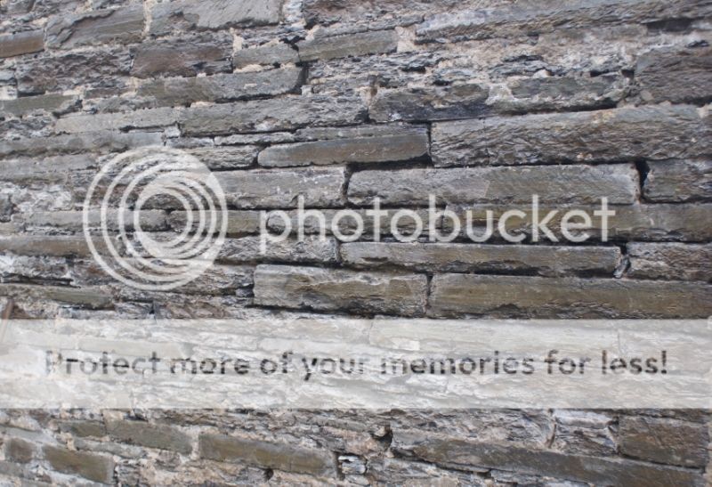

and a closer view of the stonework
So, lots to do, and I think I'm going to be making it up as I go along by seeing what gives an acceptable result.

Well now you have exposed one wall I would discount pointing the joints - you would be there forever attempting to make this good and then you have the problem of the mismatched stone work adjacent to the roof line - your research into a lime render looks to be favourable option - if you skim out the low spots first before applying a skim over the entire wall - a plastic float will probably work better than a steel one.

Re: Totally Off Topic, but need decent builders advice
Just caught up on this thread.
I am a chartered surveyor and am employed as a group construction director, a lot of what I do professionally is refurb on distressed buildings.
A couple of observations:
Watch the angle of your ladder and alway make sure some1 is footing it.
The hard paving to the yard seems to be abutting the gable? If it is, this will cause damp penetration. If it isn't then make sure there is adequate drainage at that junction.
Remove all the cement based pointing to a depth of 25mm then crack on with the lime rendering. Worth remembering that when built there would have been little thought given to providing a totally flat result, if you follow the wall and make sure you get the lime into the joints, get it to a reasonable finish it will add character and not look out of place.
Don't render to the base of the wall, I would aim to leave the bottom 150mm exposed but fully pointed up and perhaps painted with a good bitumen treatment with either a metal or plastic bell bead above it or go old school and use a wood lath to help form the bell.
If you decide to overpaint the render, make sure you use a paint that will allow the wall to breath, any decent paint manufacturer tech dept will advise on this.
Pm if you need to chat
Kev.

Kev, the ladders had been at the peak but I moved them when cleaning up so the foot is further out than I would have it in use, but must admit to being stuck for anyone to foot the them.
The flags are right up to the wall but it may be an idea to cut and lift to leave a clear section and fill with gravel ?
The house is odd in that at this end the floors are actually lower than the outside ground levels front and rear but not at the side which has a lower garden, and the large slightly raised flag next to the drystone wall seems to cover a small pit that drains freely down an old rubble drain. I think the flags here may have formed a floor for another part of the house in sometime past, possibly a second byre or outhouse / loo as the old plans show the building coming out further here up to the boundary. Fortunately we have not had a problem with damp at the low floor levels though this seems contrary to what I'd expect.
The rest of house has had the floors raised (possibly the reason for the altered roofline?) by concreting over the original flagstone floors which would also have been below ground level. Apparently it is reckoned they liked to build low up here due to the high winds we experience several times a year, 100mph plus being quite a regular occurance.

Difficult with the ladder situation, be worth looking at a ladder steady for the top.
The flags deffo need cutting back to keep moisture transference to a minimum, similarly, where the level is above the floor, either drop the external level or cut the ground back and introduce some drainage.
