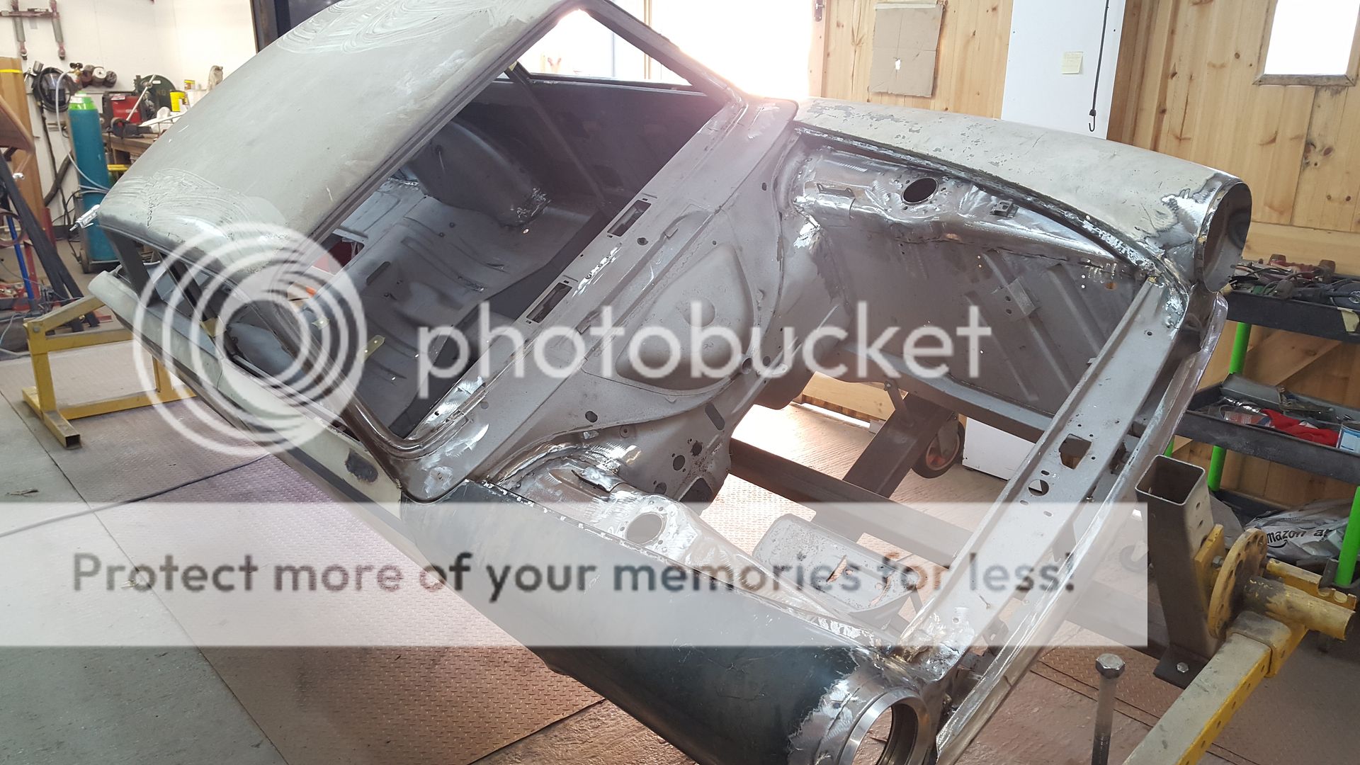

You have put a lot of hard work into this restoration, and you probably know your onions on the MK1 Cortina, or Consul Cortina as the early ones were known as. Not being someone who could hold a candle to you with your skills, this might sound just a little impertinent, I do hope not.
The photo above shows the two holes in the wings that give access to the macpherson struts. This was one of the weakest points in the design of this bodywork. Within a year or two, the struts could actually pop out. The cure was to weld strengthening plates around the holes. Whilst you have the bodywork as it is, putting such strengtheners in now will prevent this occurrence from happening, as would, purists look away now, lining the wheel arches to prevent the road dirt/rock salt/ erosion materials, reaching the rusting point.

As a past owner of two Mk1 Cortinas, I take issue with your statement that these would rust through within a year or two. I reckon at least three!
The 'strengthener' plates to which you refer, were really only intended to hide any wingworm from the MOT man, but added practically no strength to the strut mounting. It was the structure under the inner wing that carried the loads, and once this had rusted away, no amount of additional plates welded on top would work. How do I know?!
The problem with these was the virtually non-existent rust proofing applied when manufactured - not just applicable to Fords of course. With modern methods, these should last for many years.

The 'strengthener' plates to which you refer, were really only intended to hide any wingworm from the MOT man, but added practically no strength to the strut mounting. It was the structure under the inner wing that carried the loads, and once this had rusted away, no amount of additional plates welded on top would work....
Nail on head there. The load is borne almost entirely by the webs that extend vertically from the legs inboard of the lower arms to the mountings for the struts below the inner wings. Had Ford made thae upper mounts single skinned and attached the inner wing about, rather than atop, the lower loading carried at the top mounts wouldn't compromise even the one remaining layer of steel and that lazy way of locating the turrets is totally superfluous in two, let alone the three layers found on some lashed up examples.
Modern build techniques invariably make the accommodation for the top mounts in a far less rustprone, stronger and more elegant way with a single turret, shorter webs and the (surrounding) inner wing separate and lower to tie the inner wing, suspension upper mount and closure more effectively in a way that also allows more engine bay space, that last not needed in the Cortina shell of course.

Take issue all you like, you weren't in my, bought new, 1966 Cortina, when in 1968, a bang coming from the front nearside, was the result of the strut coming through. After reassuring my wife and her family that we were all ok, I contacted The AA. It was carried on the back of one of their pick up trucks to the dealer from where I bought it. They contacted Ford, who agreed to cover the cost of strengthening around the hole. Both sides had a plate welded above and below the weak spot. The dealer let it be known that Ford always carried the cost of this, if the vehicle was three years old or less, and without high mileage. So many owners were unaware of this and simply paid it themselves thinking that the car was out of the twelve month warranty.
When I sold the car, the buyer actually asked me if the struts had been strengthened, so common was it back then.

Fortunately, manufacturers don't feed that sort of tripe to their buyers these days and [the manufacturers] have a better grasp of how to cater for such loads. Fatigue or later corrosion, the top plate locates the strut but bears little of the load which, as a quick look at the methods slide for Cortinas 1 & 2 would show by all of the red shading fore & aft of the webs, is borne by these and patching it the way you described was as horrendous a bodge then as now. We saw many Sierras with holed front chassis legs under the bulkhead/heelboard seam at their first MOT, the Ford dealers' drivers always came down to spirit the cars off under cover then fixed that discreetly too but the issue there wasn't the stress, which had been pretty well looked at during the drawing, just good old inconsistent steel quality.
