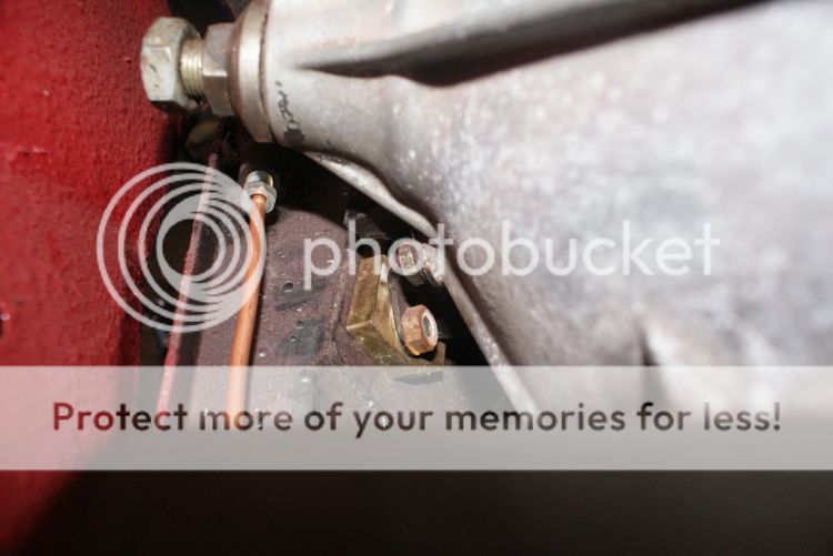

Anyways, being an auto subframe it is wider than the manual one, so the previous owner had bought conversion plates ready for us doing the engine swap
Simple enough, here is the drivers side one in place
Now try as I might, I could not find the engine mount and plate for the drivers side anywhere, the lad who had the car when it first came to our house swore it was in the boot... nothing there, so on the upside, being a mini there are normally parts to be had, so a distress call was put out for a nearside engine mount and within an hour we had one, but obviously no adapter plate.

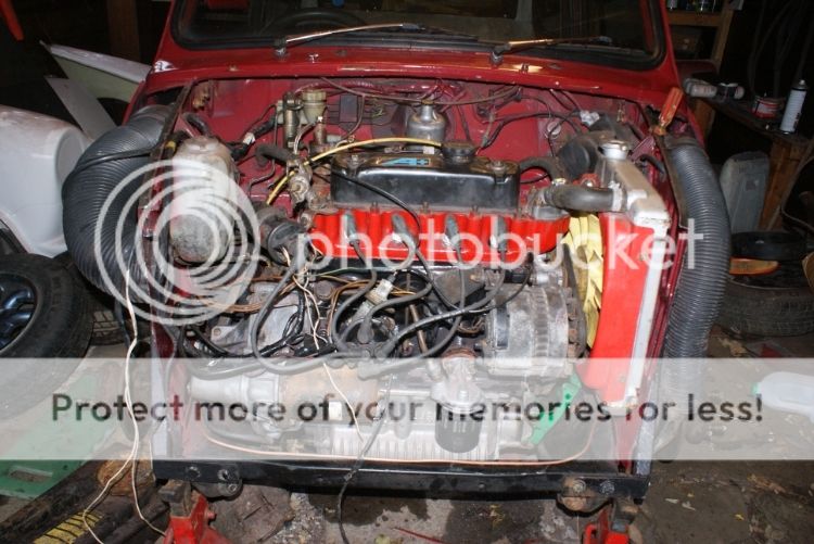

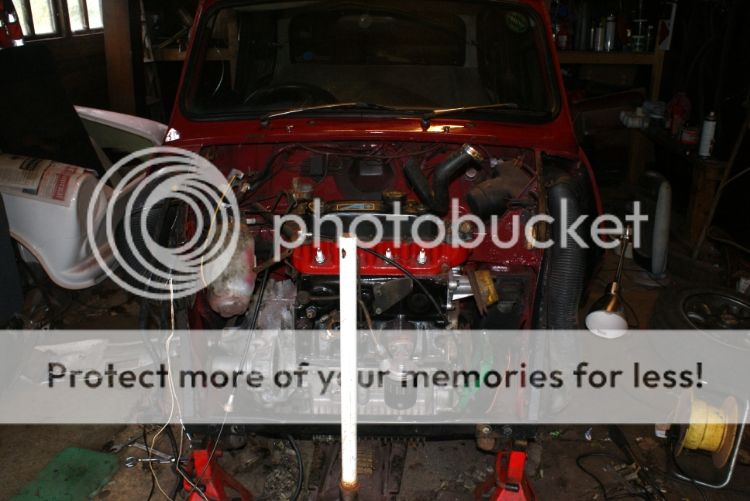

The engine went in the bay easy enough with the front end being off, just a bit of grunting and a trolley jack saw it in place
You can see the drivers side with mount and adapter plate
And the nearside with the emergency puce green engine mount and of course a little gap, though I had elongated the mount holes in the subframe so they at least match the mount hole pattern.
A couple of pieces of 6 mm plate took care of the gap and so I could get on again. Typically yesterday while searching for something in one of my sheds I found the missing engine mount and conversion plate, wrapped up nicely in a plastic bag and buried under loads of unrelated stuff. Ah well............
So a long round of fitting and building up started.
I'll just give the highlights,
the pedal box had been changed in readiness for the manual engine already, but I got the pleasure of lying on my back on floor of the mini, head under steering wheel, feet up on rear seat, in order to fit the clevis pins that connect the pedals to the clutch and brake master cylinders. I hope to god they all work ok, it took bloody hours, hours that were filled with pain, frustration and lots of swearing.
Most other stuff went quite well, this being an early 70's engine despite its A+ rocker cover chucked a couple of problems in though,
Number one being the starter motor, the mini had had a pre engaged set up previously, and now needed an inertia type starter, I found one of those and altered the wiring to suit (I shall tidy and wrap all the wiring at the end as I think this little car is going to be full of electrical gremlins from what I see here and there), I had a solenoid so mounted that but it turns out it doesn't work and has one terminal too few for my ballast ignition system, so one is on order and hopefully may even arrive today.
Number two problem was the distributor, when my lad originally collected the manual engine with his friend, they managed to roll the engine and break the dizzy cap, no biggie, but the lad whose car it was at the time for some reason took the distributor off, and away he went, then returned with distributor and cap. All well then, or it would have been if he just got a new cap, I went to fit the distributor only to find it didn't fit and belonged to a later mini. Where the original went is now anybodies guess, probably swapped for the one that didn't fit.
Now, in another shed I have an a35 engine, with a lucas 25d distributor, it is now on the mini, a perfect fit and hopefully fine.
So thats the engine in
Apart from the fact I have to bridge the solenoids terminals to start it, it works and sounds healthy, so as i say, fingers crossed it all does what it should when I get the wheels on the ground, my only real concern is the clutch / gearbox set up, when I first plumbed in the master cylinder the clutch pedal was very stiff and the clutch arm didn't return back on the first press, I gave things a wobble, and it snapped back in place, with adjustment made to the stop bolt and overthrow nuts it now seems to be actuating and returning correctly, the pedal feels right as well, so we will now just have to wait and see.

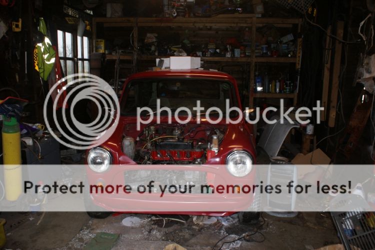

So, all was going quite well, I fitted the fibreglass front, I opted for bolts and she is on really nice and firmly though did take a fair bit of lining up and general trimming here and there to get right.
I then cut the holes for grille, lights and indicators, painted it and then got on with fitting lights and general electrical work.
That all came good, a little detective work at the 4 fuse box showed someone had put one of the supply wires to the wrong fuse, which upset a few things but once I figured that out everything worked as it got wired up apart from the hazards which turned out to be a bad connection on the wiring where someone had spliced into it in the past. Sounds simple but it took an afternoon to find it Oh, and I replaced the dodgy starter solenoid with a nice new one and she now starts on the key.
So then we looked like this

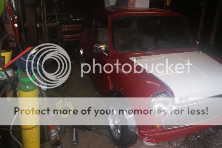

I then fitted the grille using a couple of bolts through the front so it can be taken off in about a minute rather than fiddling with loads of screws, I've always found that to be a worthwhile mod on a mini.
Wheel arches and side trims went on, again I haven't took all the pics yet but I have a couple of work in progress.
I have also fitted the bonnet, in the end I went with the bonnet pin set up for the sake of simplicity, that needs paint yet but I planned on doing that after a MOT.
