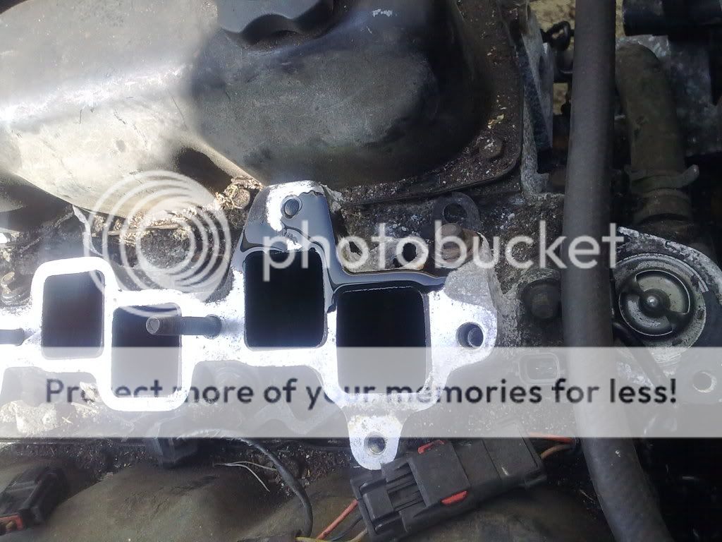

I was searching ebay for 3.3 intake manifolds seeing what other vehicles the engine I am using is in.
93 - 97 Dodge Intrepid uses the same engine and the manifold looks closer to the engine, if the bit that has the sensors on which bends the wrong way was cut off and was replaced with that bit of the Voyager's

Is it me or does the picture I have above look as though the intake manifold comes apart? If it does then it might make easier to modify.

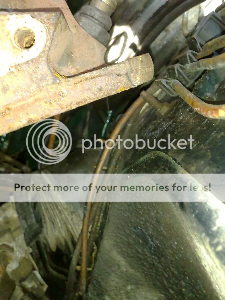

It looks like the exhaust manifold is a little too close to the firewall and the brake pipe may need to be moved
I'm wondering if the engine and gearbox might need to be tilted back
over to give the exhaust manifold more clearance.
The engine and gearbox can't go any further forward, unless I don't
mind the waight being infront of the front wheels!

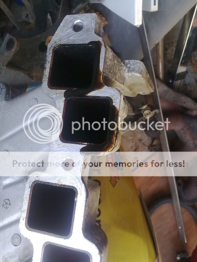

Then I removed the intake manifold to get a nasty surprise!!
Yes that black stuff came out of the intake manifold.
I pray the engine is not in bad condition even though I did hear it running.

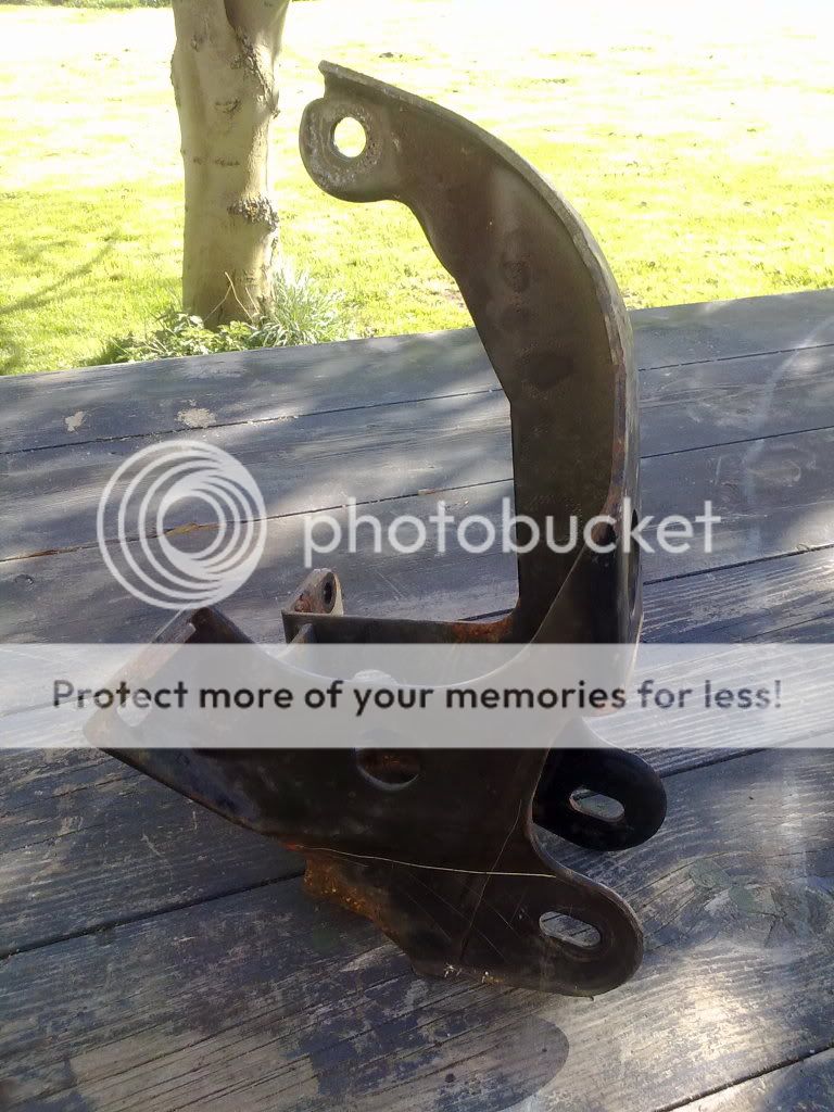

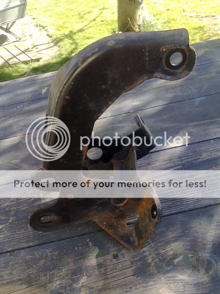

The front engine mount off the Voyager's engine before modification.
Dad took a large cutting disk to it but it still needs a little more cutting before it can be used.
Pictures of that coming soon.
