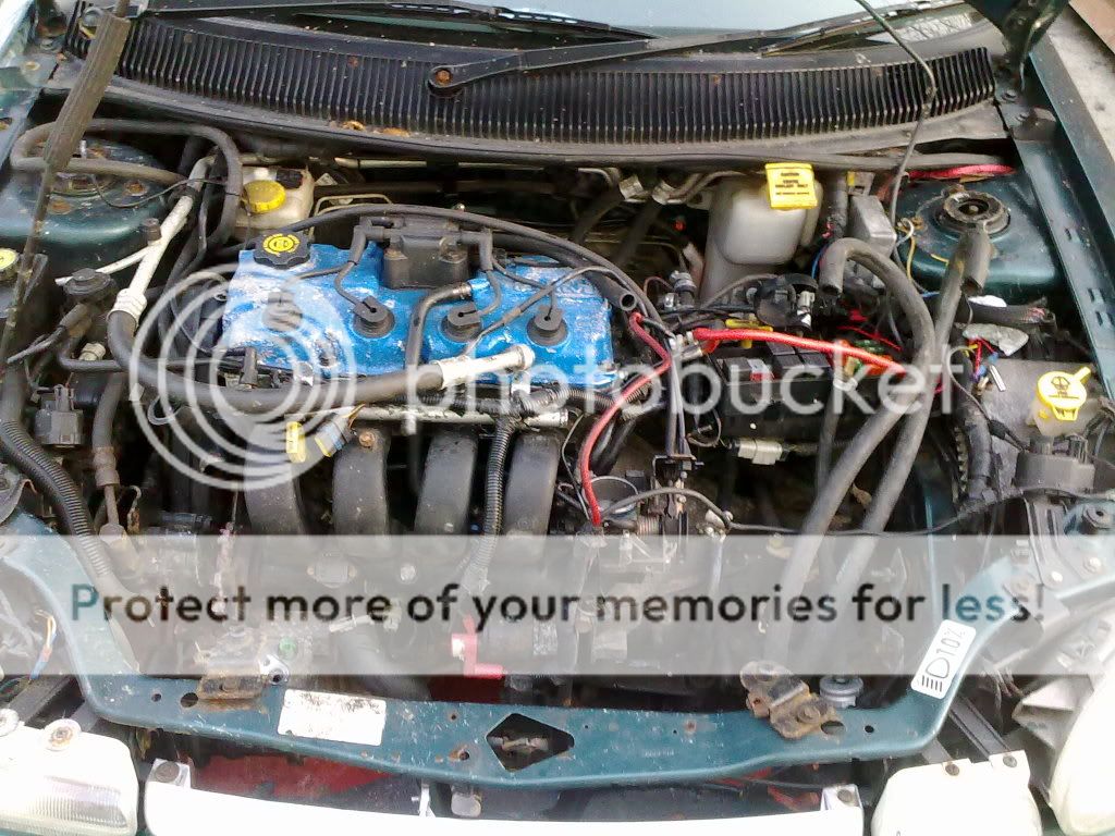

In a short break in the weather, I managed to
LPG wiring loom removed and it's ecu.
Unplug engine wiring loom and remove the 4 pot ecu.
Unbolted power steering pump from engine, but left pipes connected
(keeping original power steering rack & pump off neon)

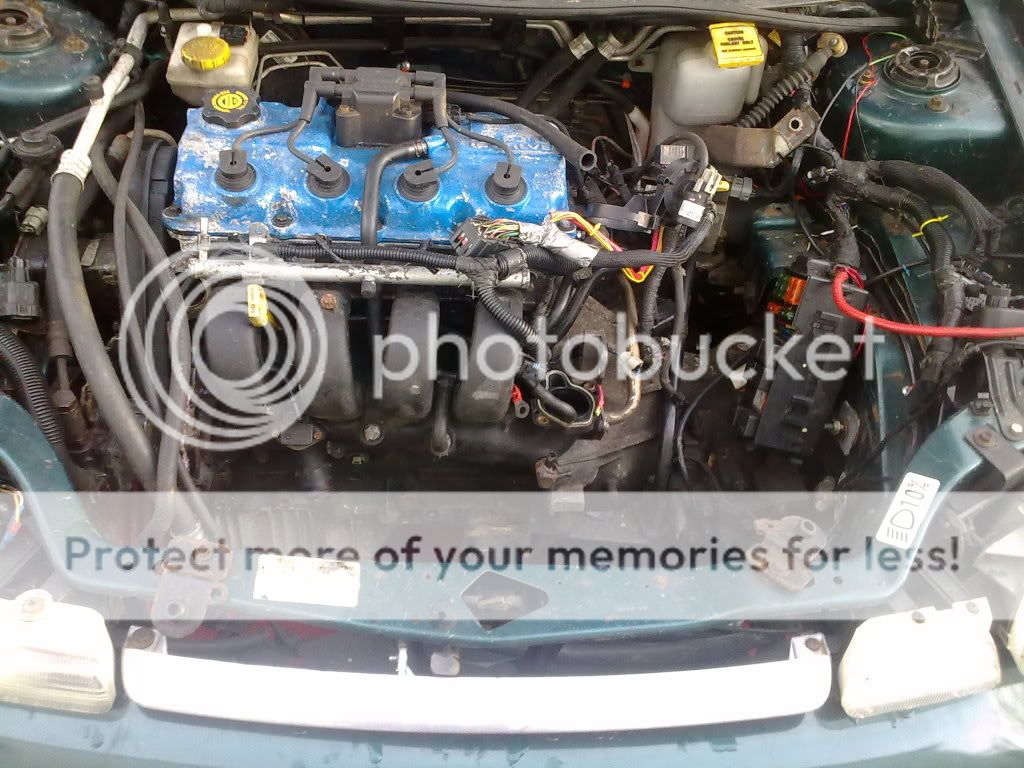

Well the altanater is problematic, and won't budge.
The A/C compressor, and its mounting bracket have been removed.
This is how she looks at the minute, I wish I had better health, so I
can get more done quickley before the weather changes
